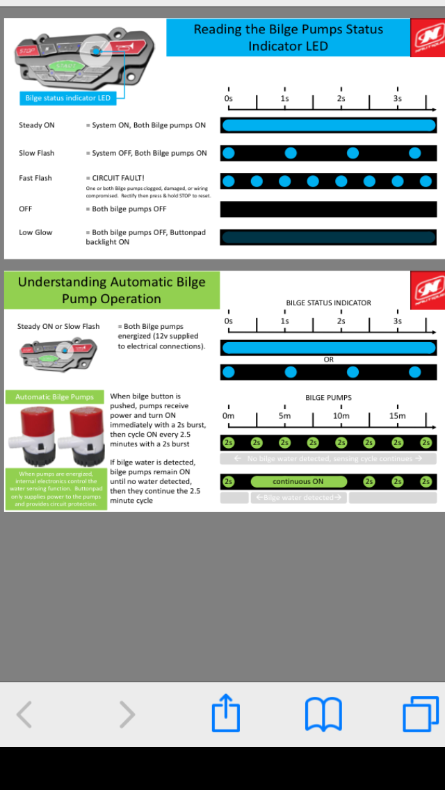

    Does anyone have the chart of the bilge that tells you which blinking light means what.? Only 6.5 hours and the light is blinking fast which I know means one is not working. Also taking on water and not sure where it is coming from?

    Click image for larger version  Name:	image.png Views:	1 Size:	213.6 KB ID:	559592
    Info here
    http://www.planetnautique.com/Correc...s/bpstatus.pdf

        I have a 2017 G25 and I've had the same issue, ended up being a bad bilge pump. I believe the flashing light means the bilge breaker has popped. I think the correct procedure to reset the bilge is to turn to motor off and hold the "STOP" button down for 5-10 seconds. Your light should stop flashing if the breaker resets, if it keeps flashing/popping you probably have a bilge that needs to be replaced. Hope it helps.
