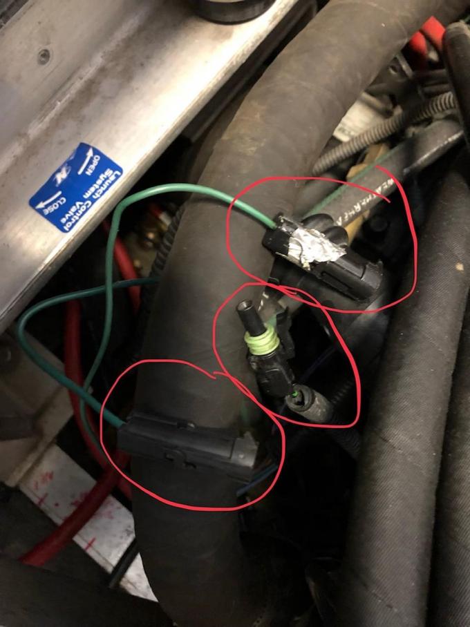

            I am not sure if anyone cares.....but.....I finally found out my speed problem...and the brake like feeling I had and the troubleshooting ALL summer long.
            I finally took it to a dealer...they spent a lot of time going through the electrical hook ups and this is what they found. In the picture there are two female plugs with green wires and 1 male. Someone.....and this could have been me not sure because I did so much work on it....plugged the male end to the female with the silver tape on it. The male plug had silver tape on it too, so it looked like it made sense that they should be connected. They all had green wires too. Turns out...they shouldn't be connected. Maybe someone else can explain it better than me, but when it was plugged in, it told the engine to cut out at a certain RPM.....higher end of course. So..when I was going at higher speeds, it would reach a point then slow then speed up..then slow. Very similar to when a rotor cap needs to be replaced.
            Technician pulled them apart.....he went to the lake for a test ride.....BAMM...that was it. Runs great, fast...slow...surf...ski.....HOLLA LOO YA!
            Anyone feel free to chime in if they know what these are exactly. The Tech has been gone for the winter at the marine shop, and I never got the full detail!

              That wouldn't be from the knock sensor, would it? I'm wondering if the issue isn't that they were plugged in and shouldn't have been, but rather, a sensor is/was giving a faulty reading and causing the issue you're describing. By disconnecting the faulty sensor, it runs better but then the ECM or whatever isn't getting any info from that sensor.
              Please keep in mind this is COMPLETE speculation. But I'm curious what that wire is, and if the problem is solved or just sort of bypassed. At least the boat runs well and you've narrowed it down to this single thing, which is a big win.

                        I can't quite make out where that is on your engine. It could be oil pressure, knock sensor, water temp sensor. If I were to guess it was the knock sensor like functionoverfashion said because the others would have given you a readout or no readout.

                          Its making a lot more sense now....I really think you could be correct......a friend was going to send me wiring specs.....location is port side below v-drive cooling tube and under oil lines port side. I really do appreciate your comments...thanks again! D BTW getting it ready to head up to flaming gorge in a few weeks.....sort of in your neck of the woods...I guess depending on where in UT.Thanks again
