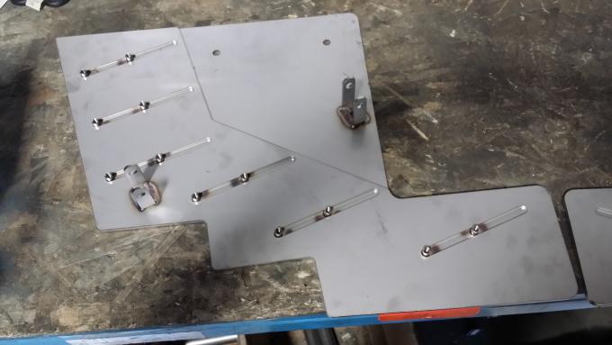

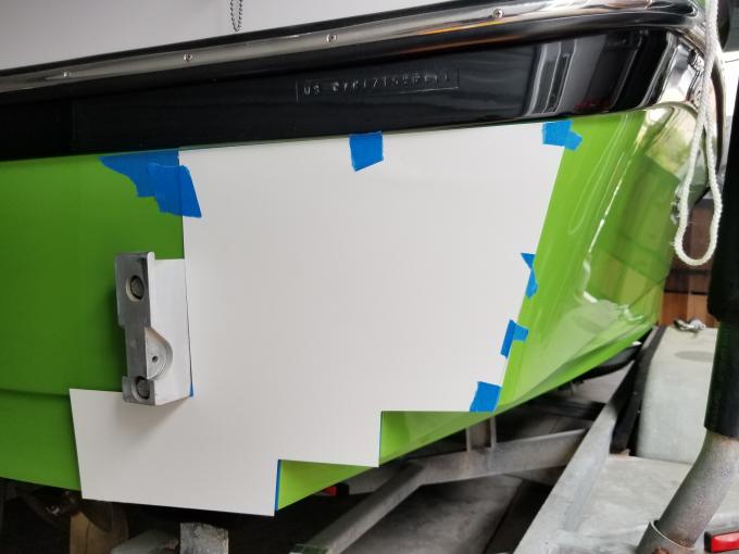

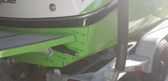

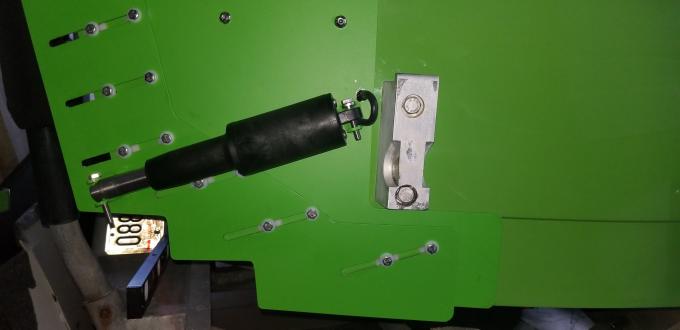

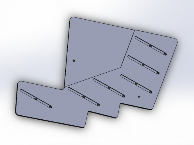

    You read it right, currently working on doing something interesting for these hulls. You may already have seen some pictures on the facebook group.
    Started the same way as the kit for the 220 and 230, we wanted something automated with better performance than the suck gates.
    Official water test is scheduled shortly.

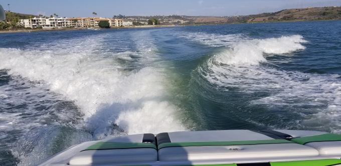

              Originally posted by martymizah View Post
              get it on the water?
              We did and results were very good!
              I will finalize drawings and make sure I cover everything

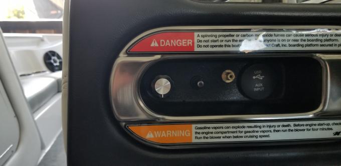

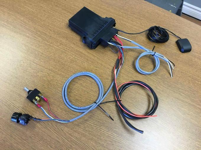

                          Looks great! what controller are you using? I see it has GPS. does it auto deploy and retract at certain speeds?
                          • max 1.6
                            • Oct 2014
                            • 284
                            • Canada
                            • 2009 Nautique 230
                            I'm using a controller I developed. Auto retracts over 15 and can also retracts under 5 (user option) for better low speed control. Will then deploy once you reach 5.
