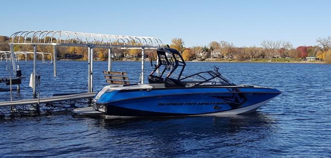

                    Someone on the forum got enough lift that he doesn't even empty ballast on a g23...which would be so nice....
                    I am stupid so i am on 3rd lift...when i got my 2008 210 i upgraded to 5000lb shoremaster cantilever which is their biggest beefiest lift. then i got my g21, and i figured - screw it - trade in values are like crap on lifts, and i wanna really see what this shizzle can handle. if it breaks i can give it away to someone who wants to weld 'er up and use on smaller boat. i only paid $3,600 for it with winch, canopy, and cover...
                    so i been running 2 years with 0 problems, 0 cable fraying, etc. BIG BUT, i have winch for much bigger weight...for whatever reason the guy that had the lift put it on.
                    so my suggestion is get 8000lb, hydraulic...
                    also i would say, that i had good conversation with couple companies, and asked why everyone buying vertical lifts...and more than one guy, after a while said pretty much just trend, everything started out cantilever, and then switched to vertical...but he agreed with me that the one cable simple cantilver design, is easier to maintain, and not as important to be level as vertical.
