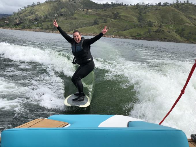

        So odd. My dealer even said their rule of thumb has been to setup and get starboard clean as it will always mean a clean wave port side. Attaching a pic showing as good as it got...not great.

          With a light load and NCRS 0 the 2016+ G23 hull will often produce a washed out wave. It helps to understand how the surf system works. NCRS (Nautique Configurable Running Surface) is the center place that works to trim the bow down. Set to 0 the plate is in the downward-most position causing the stern to ride high and the bow down). This means the rear of the hull is having the least affect on shaping the wave. With insufficient weight (not enough lead or fuel) the wave will often wash out.
          It looks like your rider is on a surf board and most surfers want a steeper wave. To do this I would suggest you fill all of your ballast (especially with only 2-3 people in the boat). Then set the NSS to 0 and NCRS to 2 or 3. At this setting you should see a clean wave, especially if you have full fuel. You can flatten the wave by setting NCRS to 2 or 1, but I would never suggest going to 0 unless you have a pretty heavy boat and are pulling skimmers.

            I will give it a try...thank you. Most of us are on skim boards but either way with a clean wave I can mess with the steepness, etc
