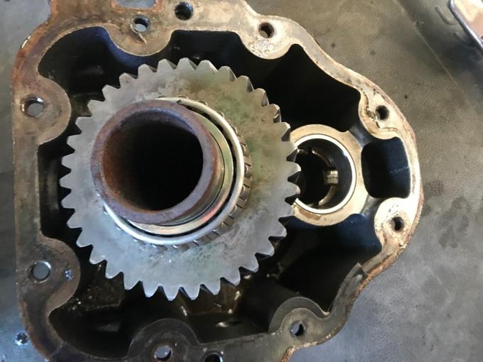

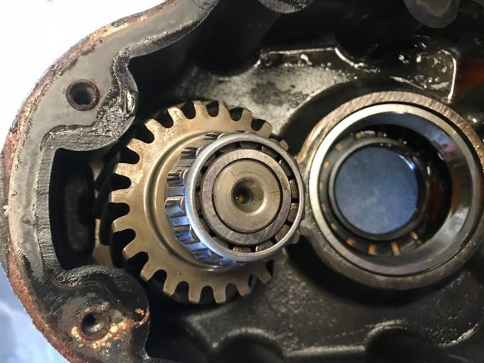

                  P.S. I would add that that I agree with "the transmission in these are a weaker link than the engines." While, they can last for seemingly ever, the v-drive or tranny can go out once you get high hours even if properly maintained. Inside the v-drive are a few bearings and seals which do wear out.
                  Click image for larger version  Name:	s-l1600.jpg Views:	0 Size:	50.0 KB ID:	579920 Click image for larger version  Name:	s-l1600-2.jpg Views:	0 Size:	55.3 KB ID:	579921
