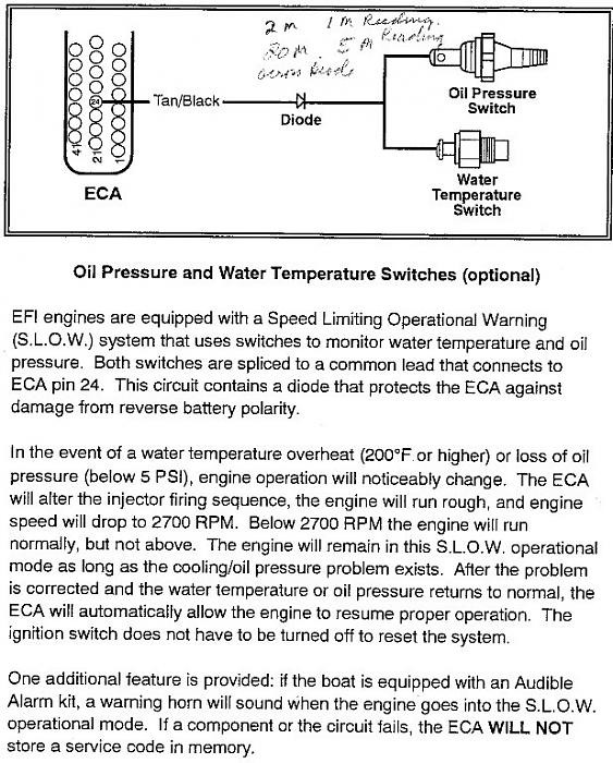

Very simple. Only two things can cause the boat to go into limp mode. One is an overheat condition, and one is a low oil pressure condition. If you really are experiencing either of those conditions, you need to figure out why. Sometimes the switches that control the limp mode fail though, and activate limp mode even though there is no real issue.
My bet is that the oil pressure switch has failed. You can disconnect the wire from that switch, and that should allow you to run the boat normally until you can get a new switch. It may also be the water temperature switch, and same deal with that, just disconnect the wire until you can get a new one and the boat will run fine.

We're talking about the SLOW system here. See diagram below.
You are the man! What else is there to say? Ended up being the oil pressure switch. For reference the temp switch is close to the top of the engine behind the water impeller. The oil pressure switch is on the stem that extends out above the oil filter. I have pictures for reference but need to remember how to use the second party page. Thanks Jeff!
