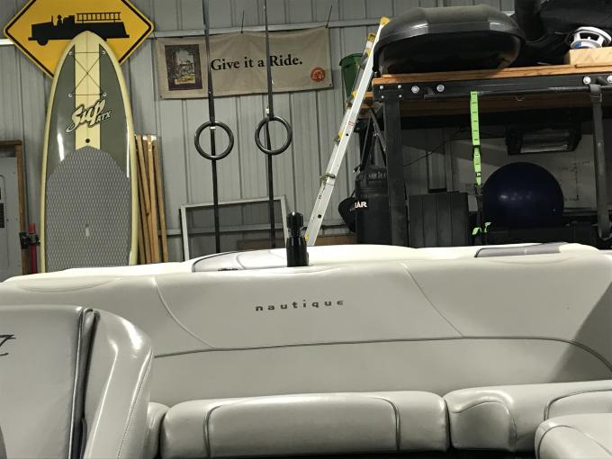

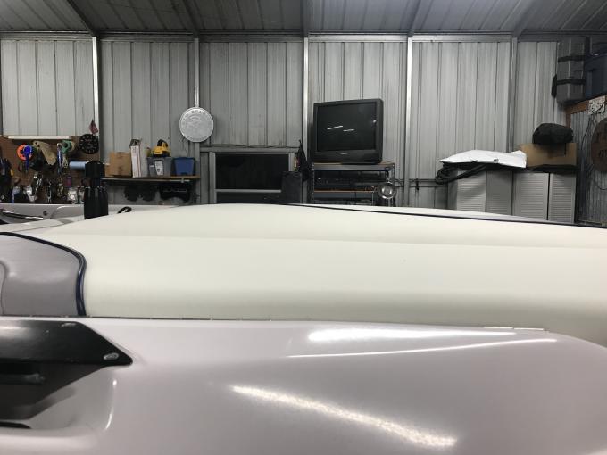

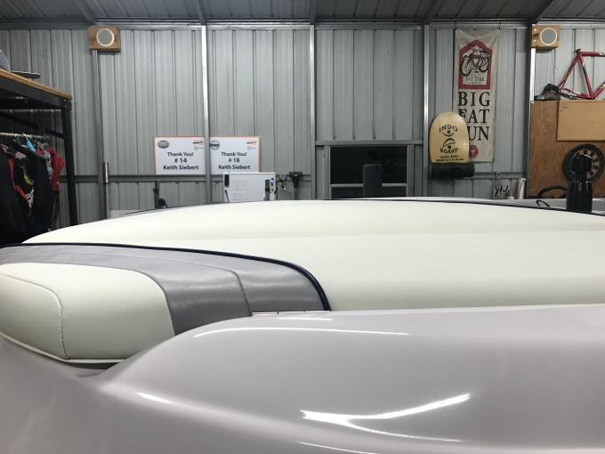

    Had some vinyl work done recently on the rear decks. Started the process in March so we could have it done by summer. 6 weeks to recover three pieces. Ok fine, we’re still good. Nope. The seamsway off in the middle and the center deck vinyl is loose. Like I can pinch it together loose. No problem, got a vacation coming up, you can fix it then. Their fix was to overstuff the center with foam to take up the space. Now this is what I have and we are now well into boating season. They have been very accommodating to try to make it right, but I honestly just don’t trust their work at this point and don’t want to lose the boat for another month. Any advice?

    Looks like you have a Python boat now. Their engine covers sit higher like that to accommodate the spark arrestor on those engines.
    If that was my boat, I would not consider that an acceptable repair at all.

              That piece will probably have to be remade. Looks like it was made too big to begin with. The vertical to horizontal seams looks like they are installed perfectly as is which means by the time you stretch the the vinyl to take the sag out of the top your seams will be pulled well past the corners where they should be sitting at. I ordered my vinyl from what used to be christines marine which is a site sponsor or advertiser here on PN. The engine hatch cover had to be stretched quite a bit to even get it on let alone stapled down into place where everything lined up. I’d try to have your shop pay for a christines marine (forgot name of new shop but it’s on PN somewhere) cover and then have them install it.

                t.franscioni makes a very good point. It does appear that the skin is too large based on the fact that the horizontal seams are right where they should be, yet the center of the skin has too much slack and bulges up (since they put extra padding in the center to fill it out).

                    They are going to remake it. The two side pieces are perfect, so I know they are capable. I just don’t want to be without the boat for a month while they do the work. :/
