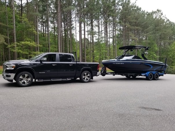

                              Not trying to get thread off track here but I use a 1/2 ton to pull my 24ft boat (Fully loaded including 500lbs of lead, its 7,800-8klbs on tandem trailer). With my previous 2016 Chevy 1500 with max tow package, 3.42 gears and 5.3 engine, it was the top end of what the truck could safely handle and steep boat ramps sometimes made me a bit uncomfortable. Beyond that as long as I didn't exceed 65mph, I always felt safe and never had any hairy situations.
                              Upgraded last year to a 2019 Ram 1500 Laramie Crew Cab with the 5.7 hemi and 3.92 gears. 1540 payload and 11,500 tow rating....with etorque option which was not something I wanted, I believe you can get up too 12,200 tow rating and 1840 payload (I verified my truck has the right class IV hitch and I also installed a 16k receiver and 10k ball).
                              With the 15" brake rotors and heavier truck, towing with this Ram is night/day difference and I am very comfortable. Its also the smoothest riding truck I have owned and I have had trucks for 20yrs including many diesels in the past. Even being a builder/General Contractor, I just could not justify the higher cost of diesel since I no longer personally pull any heavy equip and cost of ownership is a lot higher (tho they hold value much better). No doubt that a 3/4 ton is better/safer, but there are some good 1/2 tons out there now that will safely handle these boats if you do your due diligence.
