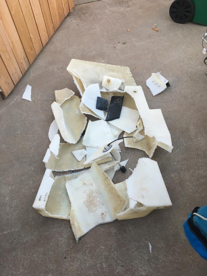

            I'm removing it to put a larger capacity bag in there. I actually removed the hard tank last summer with a sawzall. I can post more info later...

              Hmm. I didn't realize there was enough wasted space in there to warrant doing that. Hope it works out.
