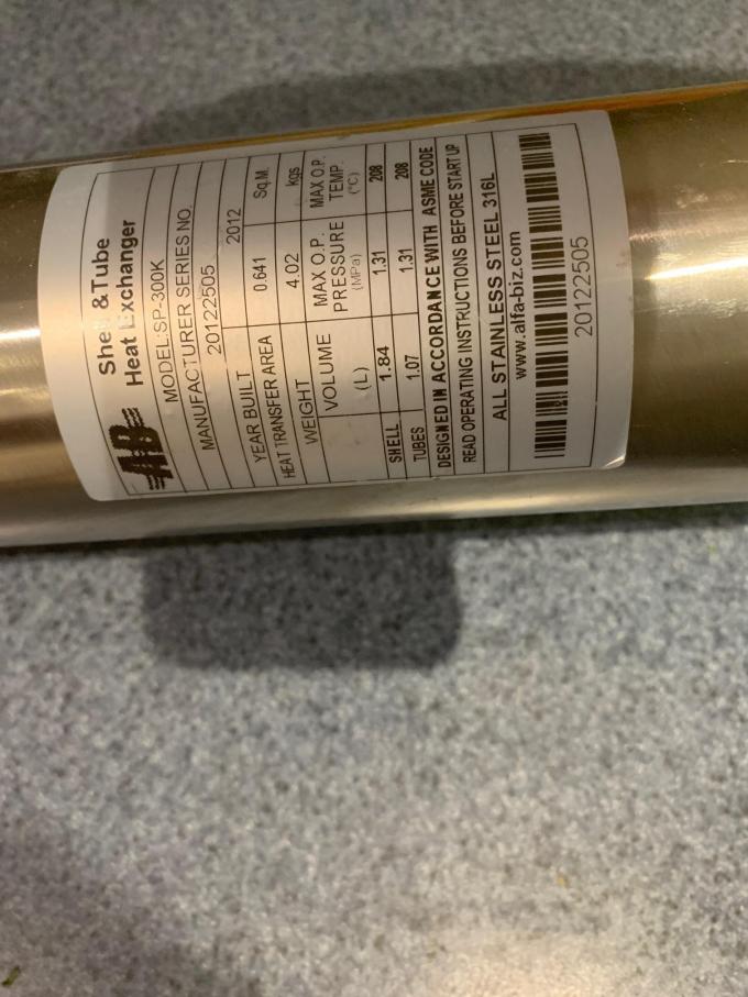

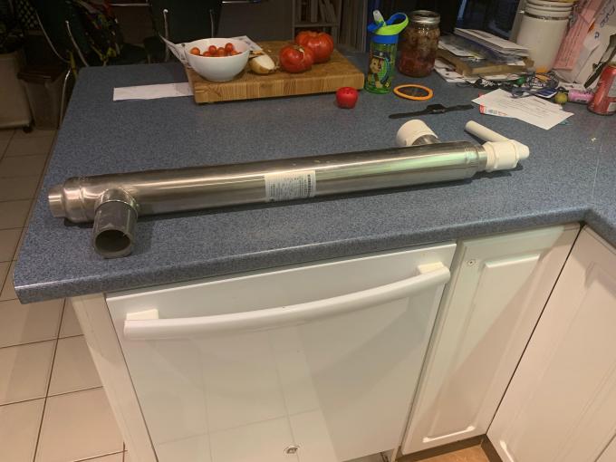

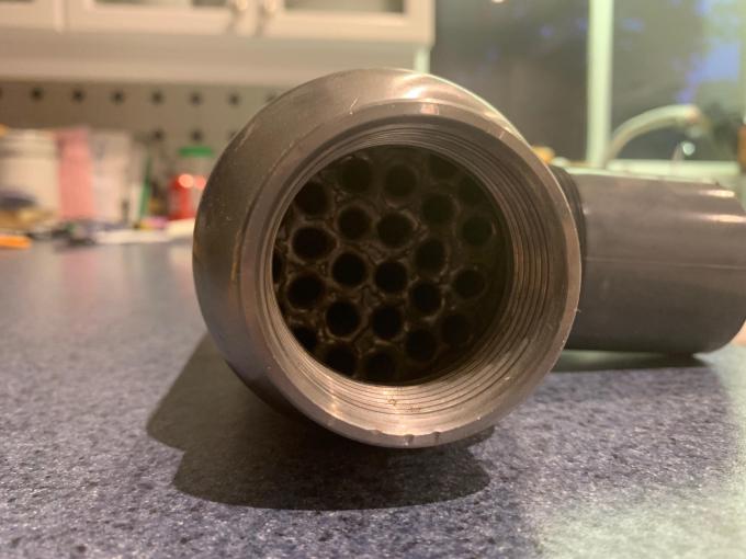

        I've been reading more about this and I see that there is both options with Heat Exchanger and without. Without a HEX, the issue is the water can sometimes be rusty. I need more of the pros and cons. And how many pumps do you need. If you go with the HEX option, then you need 1 pump for the raw water into the HEX that ends up becoming the hot shower water into the mixing valve. I am guessing you would need another pump for the cold lake water going into the mixing valve as well?
        How have you guys designed this for a boat that didn't have it from the factory?
        Lastly, I've already got a massive stainless heat exchanger I got years ago for a hottub project but never used. Pics to follow.
