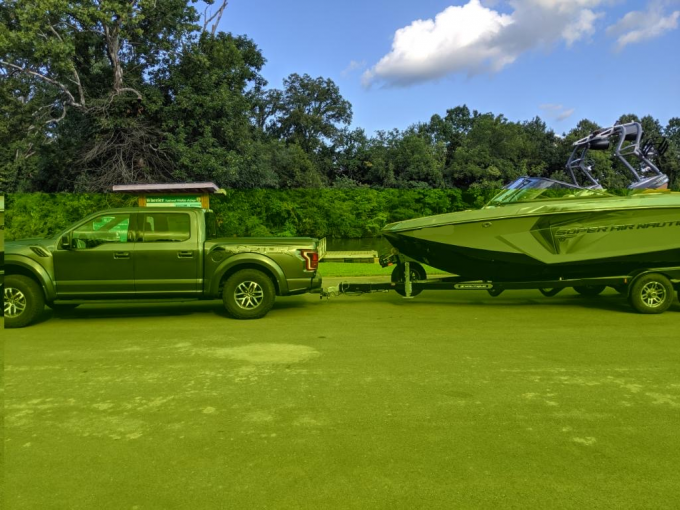

ID:	598461Seems fine to us.

                          jedpeters setup looks pretty reasonable.
                          Hitch is probably set too low in this pic. Probably just need to set it higher to get it more level after the suspension sags

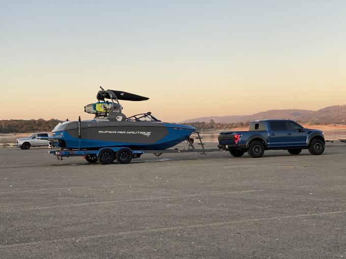

                          Click image for larger version  Name:	IMG-2738.png Views:	0 Size:	529.9 KB ID:	598474
                          • Cpan13
                            • Jan 2016
                            • 342
                            • Canada
                            • Current - 2021 G23 … Previous - 2020 Supra SL450, 2015 G23, 2014 G21, 2012 Epic 21V
                            Neither of those setups look good.
                              I agree this set up looks very unsafe.
