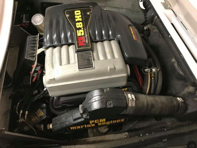

Do you know which one it is?
It looks like the ONLY options for that year are the GT-40 5.8 (310 HP), GM Apex 5.7 (320HP), and the Python (430 HP).I own and operate Silver Cove Marine, which is an inboard boat restoration, service, and sales facility located in Mooresville, North Carolina. We specializes in Nautiques and Correct Crafts, and also provide general service for Nautiques fifteen years old and older.
Post the picture. Sounds like it is probably a GT-40.I own and operate Silver Cove Marine, which is an inboard boat restoration, service, and sales facility located in Mooresville, North Carolina. We specializes in Nautiques and Correct Crafts, and also provide general service for Nautiques fifteen years old and older.
Yep! Great engine. Any other pictures of the boat?I own and operate Silver Cove Marine, which is an inboard boat restoration, service, and sales facility located in Mooresville, North Carolina. We specializes in Nautiques and Correct Crafts, and also provide general service for Nautiques fifteen years old and older.

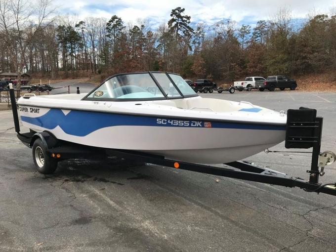

Looks like a very nice clean boat. The first question I would have is, where are the other cushions? Is there a cover, what kind and what shape is it in? Assuming the cushions are somewhere to be found it would appear the value on this boat is somewhat fluid. From what I'm seeing on line derivatives of the model and aprox age/hours are going anywhere from from $17K to $25K with most everything on the higher end having a tower ballast and speed control. While this boat looks to be in great shape it also has few options with exception of that great engine, which is very important.
