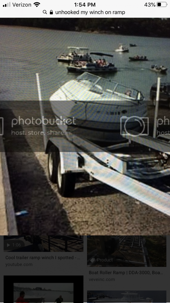

      Click image for larger version  Name:	34A523B9-6037-4731-9B46-1C9E190C6231.png Views:	0 Size:	958.2 KB ID:	616247
      yes you can also get the pic of the tow vehicle in the water but if there is any doubt about the ramp, take a walk down it and see if it’s slippery. I use an F150 and rarely have to use FWD. the van is going to be heavier in the rear end than a 1/2 ton pickup.

          I would NEVER unhook my winch before backing down the ramp. Unhook it before it floats yes but you don’t want your boat sitting on the ramp.
          Sorry to be unclear - my comments presumed a bunk trailer. Don't unhook the winch on a roller trailer until the back of the boat is in the water.
          But point of the caution still applies - don't back the boat so deep in the water while the winch is still hooked up that the front of the boat starts floating. The floating boat can pull upwards on the tongue of the trailer and reduce the down-force and traction of the back wheels of a 2wd tow vehicle.
