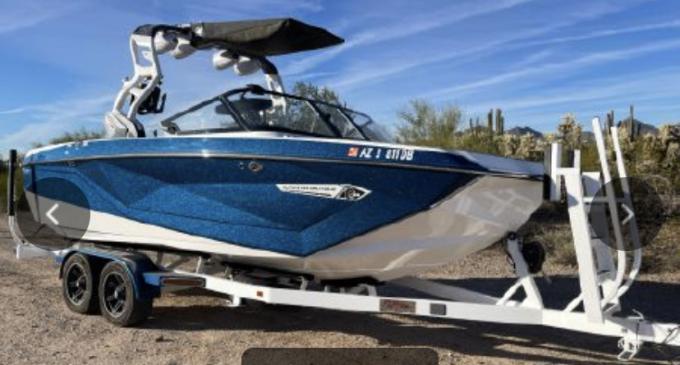

              Thanks for this great info. I just bought a 2021 G23 out of state and haven’t gone to pick it up yet, and I’m trying to figure out the tongue weight I’ll have to add to my payload calculations.
              Your 2020 G23 is only 100 pounds less than my 2021 when dry, so I’d assume my tongue weight is also right around 700 pounds, depending on the trailer? All I know is my trailer is a two-axle BoatMate, pictured. Is my trailer similar to yours? Think my tongue weight is also around 700 pounds?

                i also have it on a two axle Boatmate, just keep in mind that tongue weight is heavily dependent on you having a level load. When I first setup the trailer I attached it to the truck on level ground and adjusted my tow ball height to ensure the same distance between the ground and the primary Structural beam at the front and rear of the trailer. I think it was 21-22 inches above the ground, but it has been a while and I may be off. The key is to ensure the trailer sits level when attached to your truck with the trucks rear axles compressed under the trailer weight. Also, boatmate sent me my actual trailer weight based on the options I had them install (ladders, etc). Give them a call and they can easily provide you your actual trailer weight. Hope this helps
