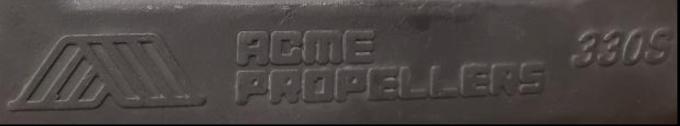

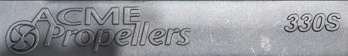

              So according to ACME there are at two versions of the 330S. The latest version has been redesigned with a wider opening to accept the new strut on the G23 and Paragon. This puller was first sold in March of 2020. This puller can be identified with the new wave ACME logo. Below are the images of the first generation and latest version of the puller logos. ACME is currently out of stock of the new versions.
              First generation older than March 2020 will not fit 2021 G23/Paragon.

              Latest generation produce after March 2020.

              • FOB1SAN
                • May 2019
                • 131
                • Boerne, TX
                • 2022 P25 Current 2022 P25 Previous 2021 P25 Previous 2021 G25 Previous 2019 G25 previous 2018 G25 previous
                #22
                Cool. Looks like I need a new prop puller!
