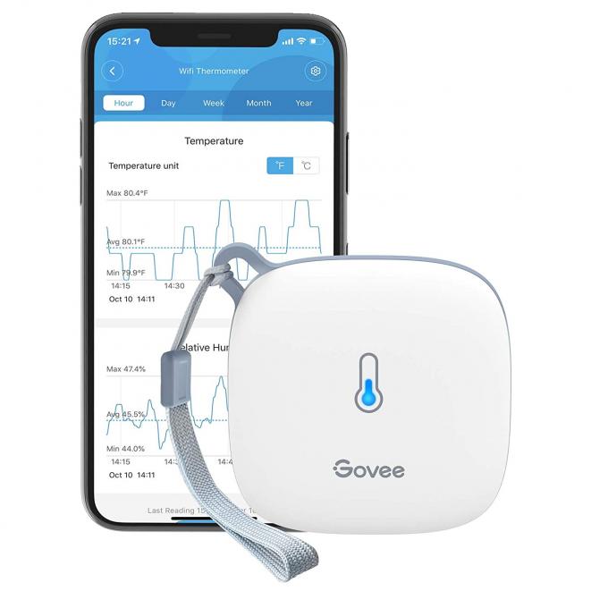

I have a cheap WIFI temperature sensor that I hung in my engine compartment, and it connects to my WIFI system (that is extended to the dock area). I can monitor the temperature and humidity in my boat's engine compartment on my phone. It will also alert me if the temperature falls below 40 so I can investigate what's happening.

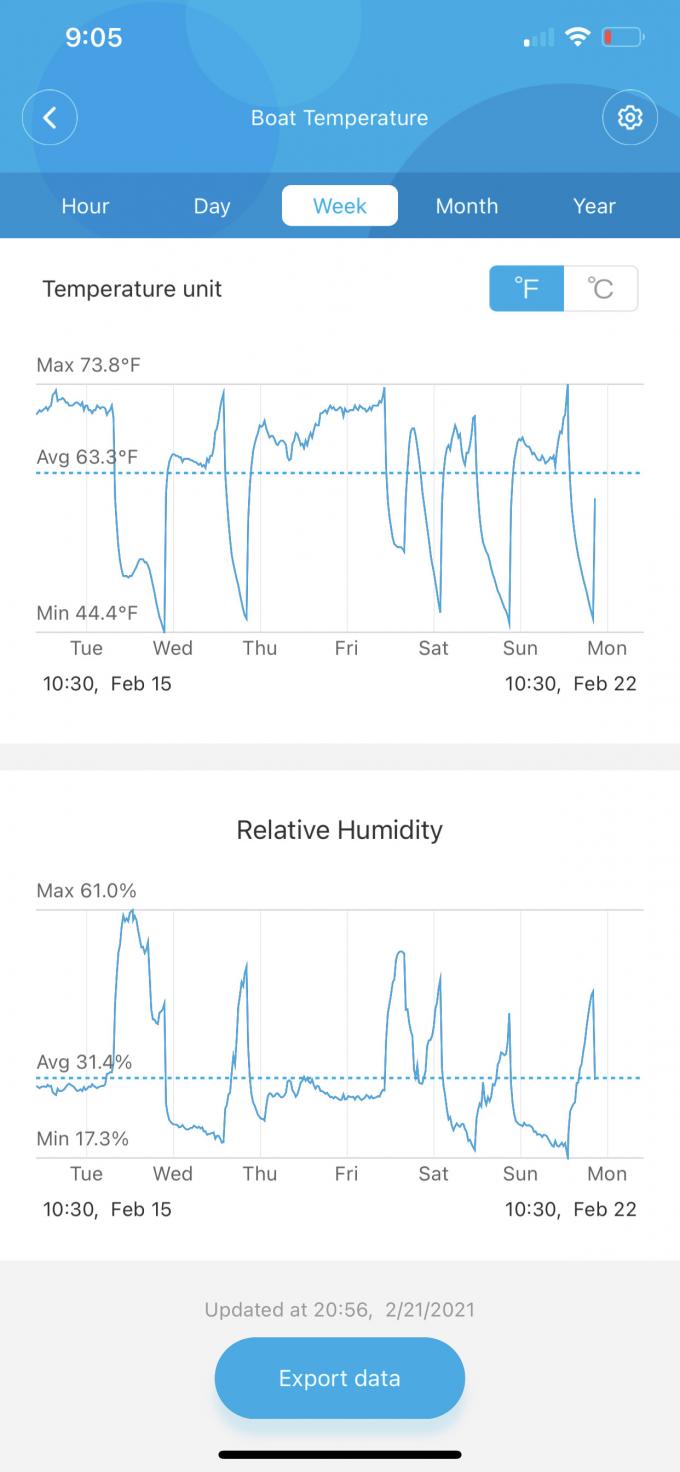

The Xtreme Heater kicks on at about 44 degrees, and, in my experience, runs until my engine compartment reaches about 72 or so. Now, the temperature sensor is mounted about 12" above the Xtreme Heater, so that explains the difference in their claimed temperature trip points and what I see.
Here's the graph of the last week or so in my engine compartment. As you can see, the Xtreme Heater just kicked on in this screenshot. It'll be toasty in there soon.
