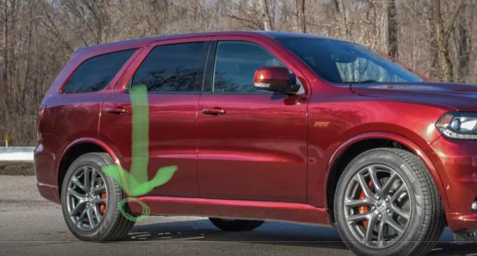

                There’s no issue with your exhaust going underwater. For me, I don’t like to go deeper than the rock rail (painted metal) in front of my rear tire.
