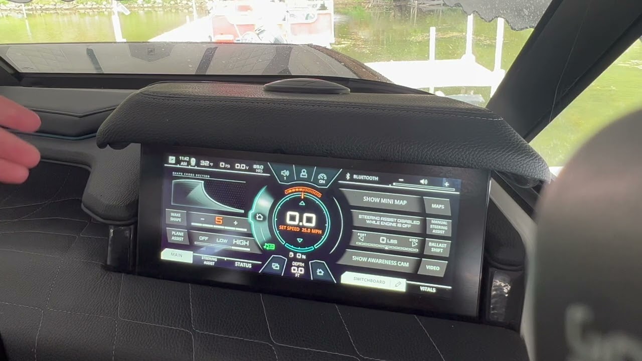

              Hi macpres - I Have a 22' G with supplemental but have plumbing in thru the overflows additional bags in the midship seating - when the stock fills and I hit the manual fill it only runs for a very short time then it auto cuts off so you have to keep hitting this many times ...... it doesnt cut out when you do manual empty once the stock volume has been pumped out however- Is there another setting In the LINC that you have activated so get this system to run continuously when manual fill is hit after stock cuts off?

                @blufy sorry for seeing this so late, but if you havent figured it out yet, you can reset timers in dealer settings, thats how our system works, but it is only one bag, not sure if itll work the same but heres how to do it:
