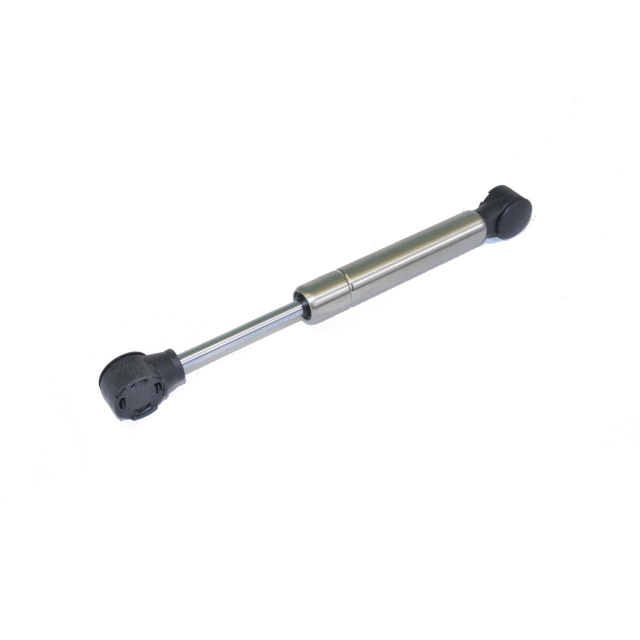

    The time has come to replace my gas shock in my glove box vs using my head to hold the box open while I search for something inside the glove box. Question, I have ordered a replacement SS shock but how do you Best remove the existing shock without breaking the plastic ball joints in the removal and/or install?

    I replaced mine and it popped out without breaking. I had to force it pretty good before it came off. Putting new one on was easier than coming off

      IIR, there is a little spring clip you can relieve with a small flat blade screwdriver...do this and it will help release the tension.

          It's really easy. If you look closely at the ends of the gas spring, there is a metal band that snaps around each end. Use a small flat-blade screwdriver to slide it out. It doesn't come all the way off. It'll slide out 1/4" or so. Once this is away on each end, the gas spring will come right off without force.
