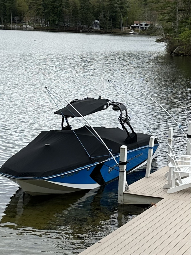

      Click image for larger version  Name:	IMG_4539.jpg Views:	0 Size:	288.3 KB ID:	677144
      My whip setup.
      Some notes:
      - Whips should line up directly with where on your boat you're tying them off. My front one isn't perfect but it's where we put the blocking for the whip foot when we built the dock.
      - Using the whips and dock lines with the factory cover sucks. You will need to untie the boat and pass the lines through the hole in the cover to the cleat.
      - My cover was custom made to wrap around the tie off points. This way my boat can be fully tied off and I can put the cover on without fiddling with any lines. Very helpful if there's a stiff wind or anything.
      - You'll want blocking under the dock to re-enforce the whip foot.
      - I use two lines to each cleat as a fail safe and also helps with fore and aft movement. We get some pretty stiff winds/storms and in all but the most severe broadside gale, my boat does not touch the dock or move much at all.
