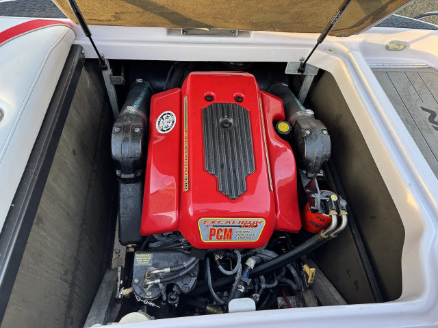

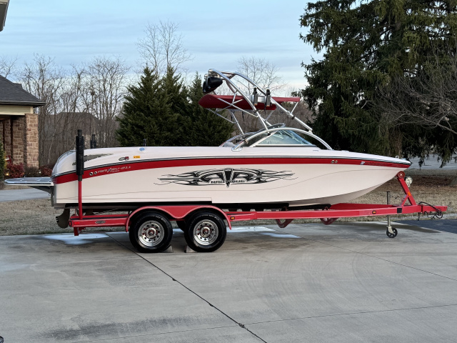

                Thanks again. this is all very helpful information. Here are a handful of the pictures I received from the seller. appears to be in tip top shape visually.

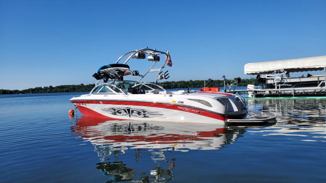

                          That looks a lot like my '07! I've just got red on the bottom of my hull, and the interior vinyl is slightly different.
