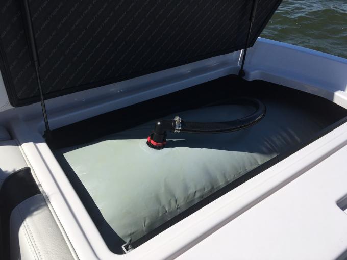

      I finally took a picture of the 650lb "ExactFIT" upgrade from Wakemakers. We're loving this setup. With these and the belly filled, I'm getting a ton of push way back on the wave -- with only a driver in the boat. I'm 200 lbs and ride a Sweet Spot board.
      Sent from my Pixel 2 using Tapatalk
      Looks pretty similar to mine.
              TO CLARIFY - the trays do not fit with the Wakemaker's Piggyback 650 lb. sacks in a 2014 SAN 230?
              • markj
                • Apr 2005
                • 1194
                • NorCal
                #127
                They don’t fit with mine, but mine are custom and bigger than 650’s.
