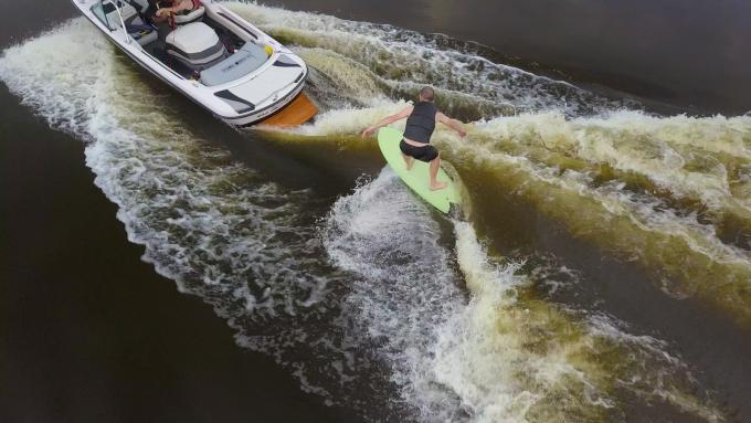

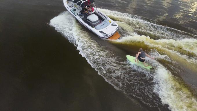

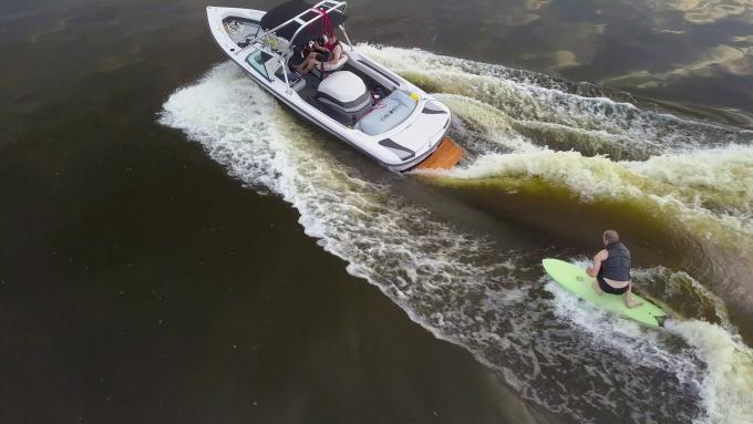

        My 99 Sport is probably similar to your 2002 (both DD). I currently surf with:
        800lbs in rear locker
        200lbs on floor behind engine
        800lbs on back seat
        475lbs next to engine (surf side)
        370lbs in ski locker
        homemade shaper (shown earlier in this thread)
        1.) I have not compared my homemade shaper to a delta/similar so I can't say which way to go, mine has a pretty big face at 45 degree angle and seems to work really well.
        2.) My wave would probably still be decent without the 475 next to engine (especially if some of it was made up for by a passenger - usually I have driver only) I would plan on using a bag on floor behind engine to help hold up a larger bag on the back seat. Also, plan to fill that rear locker obviously- this is what I have in mine and it fits perfectly https://www.the-house.com/wkslsm8001...last-bags.html
        3.) You can get more weight in the bow than the ski locker so I'm sure it would help- for me the ski locker was automatic because I have it plumbed in with an impeller pump. I have toyed with bow weight but it was only when we moved weight from the back to the front, so it did not help in that case....
        4.) I am running an Acme 422 and it seems to work well.
        My wave is good enough as-is currently that I don't dream of adding more ballast (like I did for a year or so). I think it is a good, solid wave, without getting to crazy or dangerous. Let me know if you have more questions and good luck with it!
