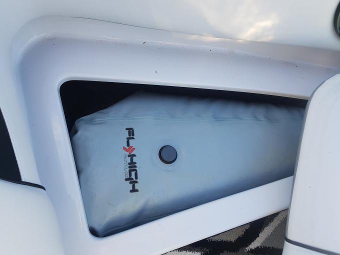

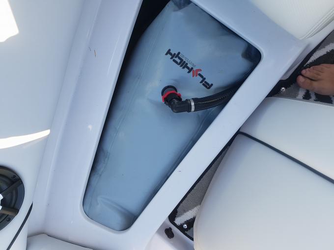

              #21
              Here's so Click image for larger version
ID:	535448 me pics of my bow v sac filled. There is definitely more than 290 lbs in it i would think.
