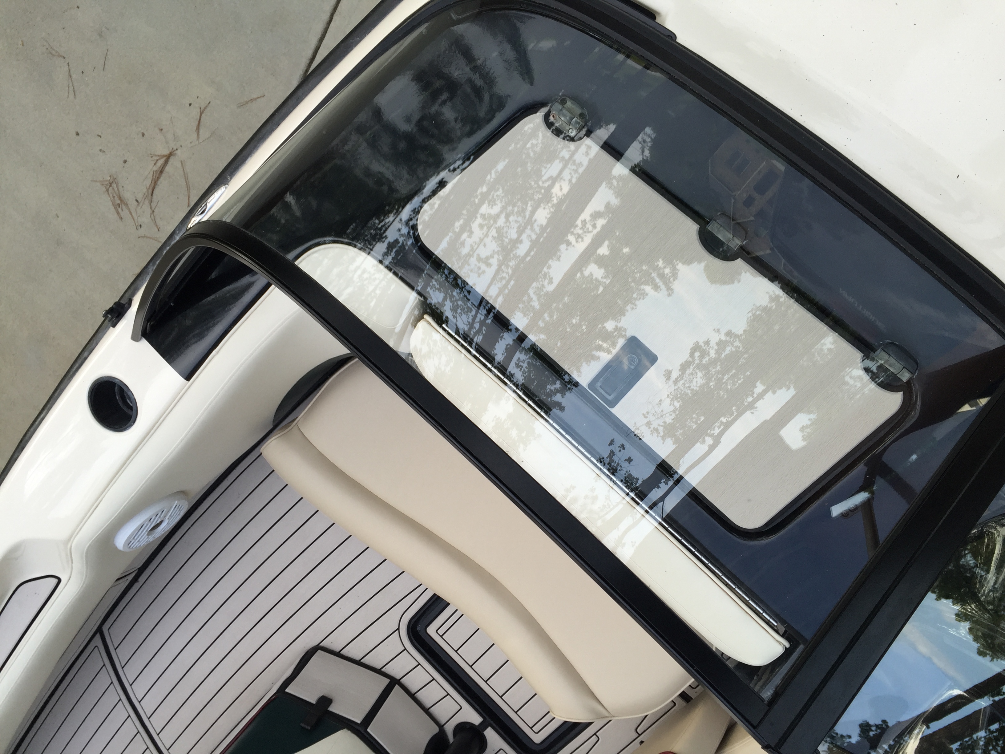

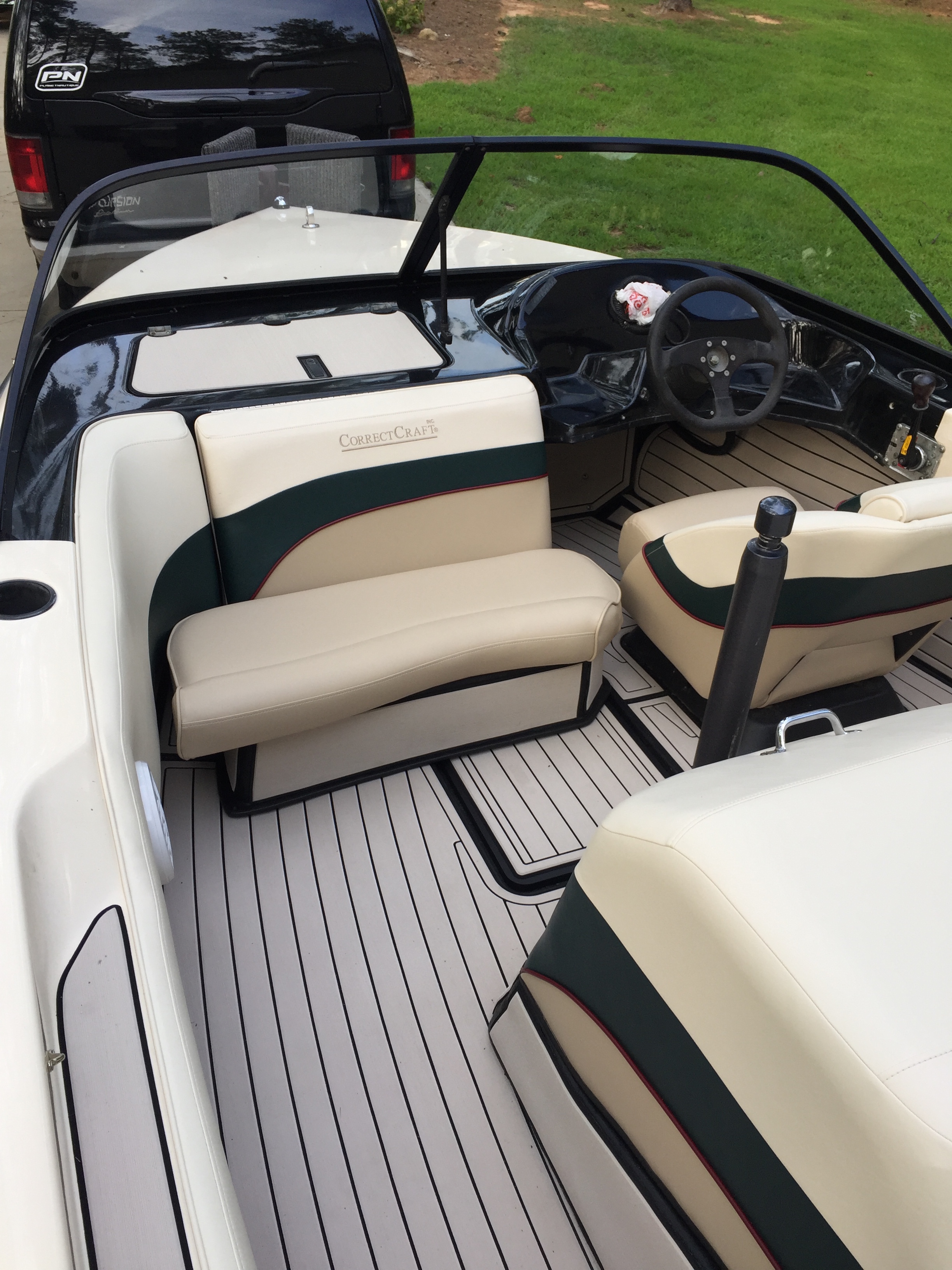

Jeff, did they spray the black gel coat directly over the raw fiberglass? Or did the fiberglass have to be sanded smooth first or preped in anyway with a skim coat to smooth the surface out in order to remove a lot of the "imprint" of the glass fibers to have a smooth surface to gel coat over?
when gel coat was sprayed was it thickened at all? To provide better fill and faster buildup? Did the gel coat then have to be polished after it was applied? This would help a lot of us who may follow your sea deck application and use gel coat instead of other alternatives.
The floor was sanded after the carpet was removed. It is a messy process, but it is necessary in order to smooth everything out and eliminate glue and carpet fibers. The gelcoat was then sprayed directly on the fiberglass. I am not sure if they thickened it, but I don't think so. It is not polished, so it isn't shiny. You could do that, but it really isn't necessary. Only a small part shows.I own and operate Silver Cove Marine, which is an inboard boat restoration, service, and sales facility located in Mooresville, North Carolina. We specializes in Nautiques and Correct Crafts, and also provide general service for Nautiques fifteen years old and older.

Got about half of the interior installed today. Had to make a couple of trips to the hardware store (funny how nuts and bolts go missing during these projects). I was hoping to get it all installed today, but it just didn't happen. Tomorrow's the day!

Interior is installed with the exception of the panel around the throttle arm. That one is being adjusted a bit by the upholstery installer tomorrow morning, after which it will be installed.
Tomorrow is water test day! Can't wait to get this boat out on the water!!
