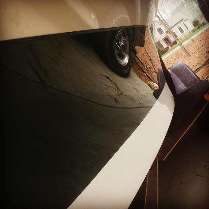

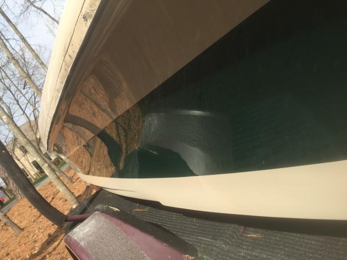

Originally posted by Quinner View PostJeff, for the areas not repaired, did he have to wet sand and if so what grit did he start with? If compound only, what did he use?? Looks to be coming back nicely from the pics.
As for buffing compound, I've used 3m Heavy duty and a lot of others, however my favorite by far is still "Buff Magic" by Shurhold. That little 22oz can did my 20' boat 2x, plus a little more. Its great to use on metal, too. I like it because it seems to cut better in my opinion and not only does it cut but it breaks down and polishes all in one step. Just have a lot of wool pads for you buffer around. I actively used 3 while washing the other 3. Reminder that with buff magic, less is more.
I would pick a 12x12 area, and spread the Buff magic over it with an old pain brush. Only thick enough that the gel coat was just covered but you could still barely see it underneath. You'll eventually find the right amount for your application.
My first year of buffing, I used a Porter Cable Dual Action Buffer. Worked great and allowed me to learn how to properly buff Gel. It was slow though. A Couple years later I upgraded to a regular Buffer. I swear I got the boat done in 1/3 of the time and it shined even more. However, if you're not careful you can burn through the Gel with a full rotation buffer. Just take it slow. I would always use speed of 5 or less.Last edited by vvfdfirefighter; 03-12-2016, 10:18 PM.2007 SANTE 220 - ZR 6 Engine (Bought 2015)

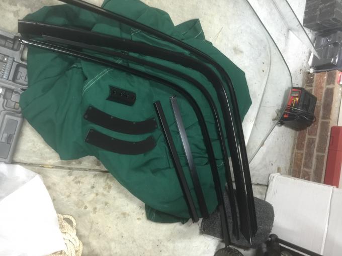

Got the windshield frame and other small parts back from the powdercoat place today. Very happy with the results, especially since they only charged me $125!

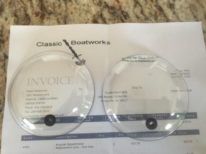

Also received the new lenses for the Airguide speedometers in the mail today. I'll get these installed tonight and get the dash back in the boat very soon.

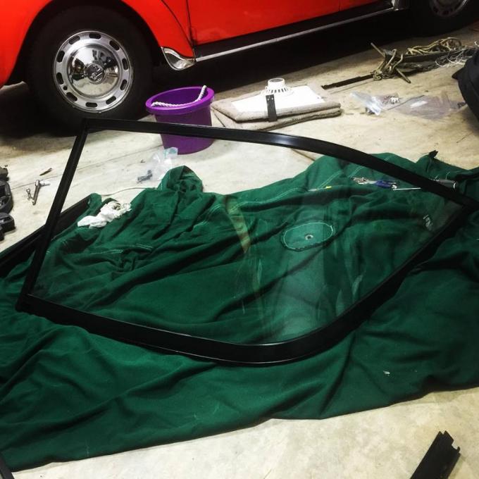

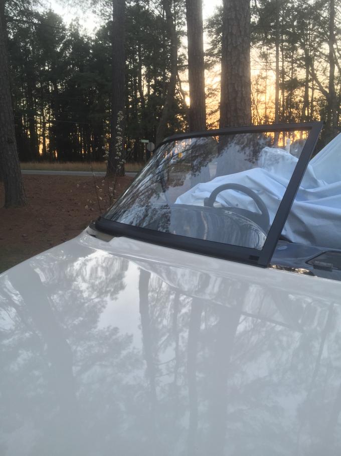

Got one half of the windshield reassembled this evening. It was much easier to reassemble than it was to disassemble. I had always heard that the opposite was true.

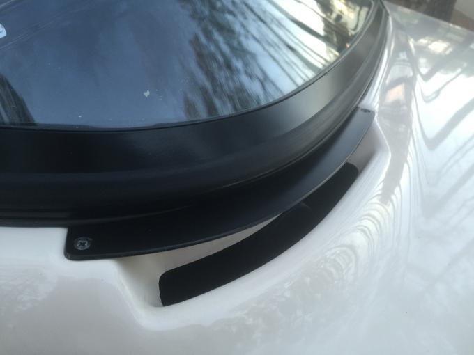

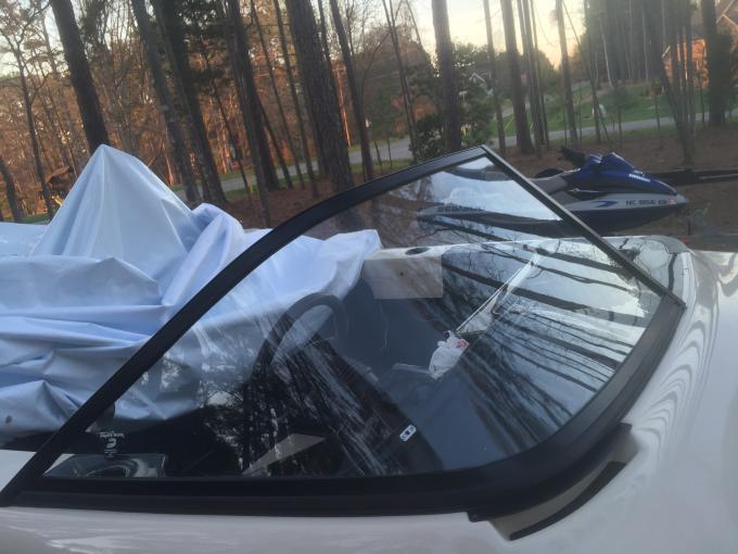

Got the rest of the windshield reassembled today.
I mounted half of the windshield on the boat, and I also mounted the front vent covers, fresh from the powdercoat shop.

Originally posted by Tjca77The powdercoat on the windshield looks great, how hard was it to reinstall?
