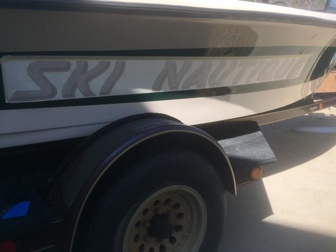

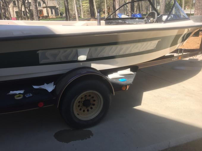

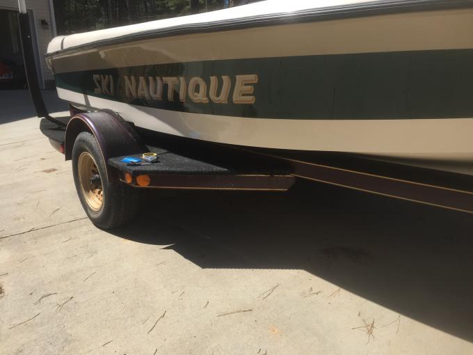

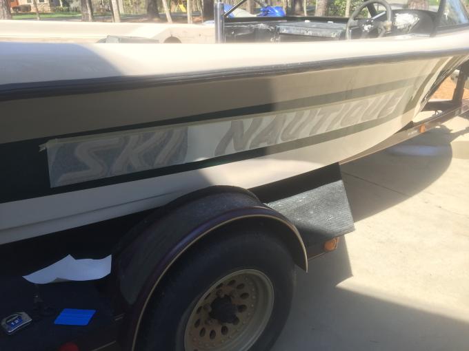

I took the boat back to the gelcoat place this morning, and they knocked the gel down some more on the driver's side so that the old letter locations are no longer visible. I brought it home this morning, and installed the driver's side graphics. Since there were some questions about graphic installation, I decided to better document the installation on the driver's side.

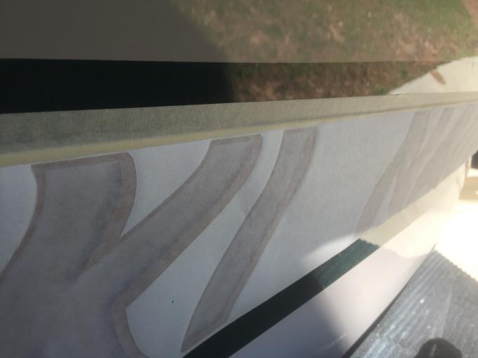

Starting at the end of the windshield, center the graphic in the middle stripe, measuring top and bottom at both ends to get it as close to perfect as possible. Run a single strip of masking tape along the top.

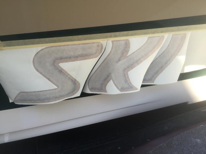

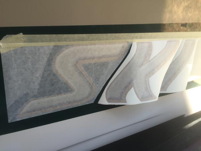

Separate each letter by cutting up toward the tape. This makes the graphic much easier to work with, since it becomes many small graphics instead of one huge graphic.

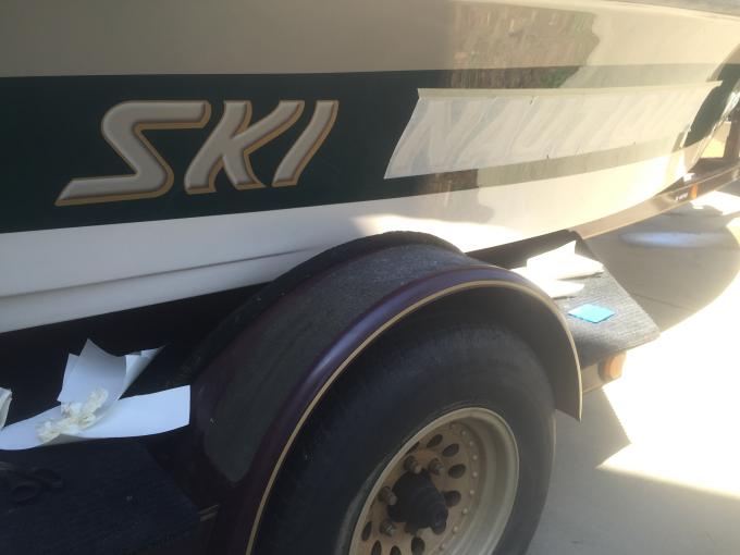

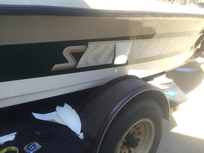

Flip each letter up (one at a time) and remove the backing. Use a squeegee and apply the letter by pulling down from the tape line. This should prevent air bubbles and apply each letter straight.
Repeat until all letters are applied.
Remove the tack paper from the front of each letter carefully. Inspect for any air bubbles and work those out by hand.
After all paper is removed, check over one last time for any air bubbles, and address as necessary. If you did your squeegee work properly, there should be very few if any air bubbles. Stand back and admire your work!

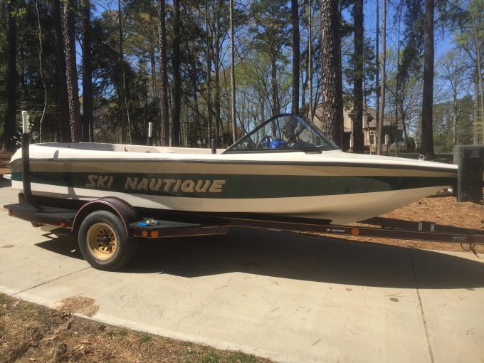

Tomorrow morning I am heading for Florida with this boat!
First stop will be PCM, in Little Mountain, SC. I am not sure exactly what they want, but they asked me to bring this project by their headquarters on my way down to Florida, so I will do it!
Next stop will be SeaDek in Rockledge, FL. I will drop the boat off for SeaDek to scan, build, and install non-skid flooring. They may also build and install SeaDek on the engine cover base and seat bases. It depends on what we decide once I get there. They will have the boat for about two weeks.
After I drop it off at SeaDek, I will head over to Roswell's World Headquarters, also in Rockledge, FL. They are providing the audio system for this boat. It is going to be simple, yet modern and unique. They are also providing underwater lights. I am going to pick up this gear and install it when I get the boat back from SeaDek.
When I get home in a couple of days, I will concentrate on what I can do here without the boat -- Swim Platform, Upholstery (it is currently in production at Christine's), and working on the black trailer.I own and operate Silver Cove Marine, which is an inboard boat restoration, service, and sales facility located in Mooresville, North Carolina. We specializes in Nautiques and Correct Crafts, and also provide general service for Nautiques fifteen years old and older.

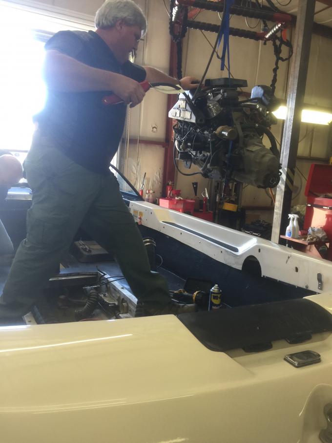

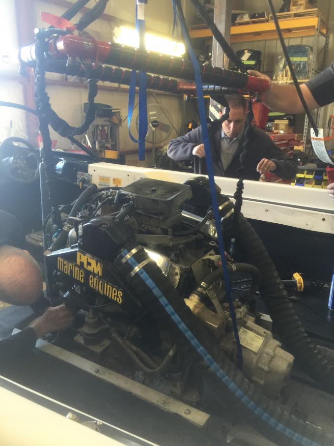

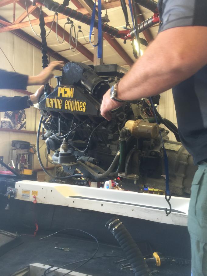

So I stopped by PCM this morning on my way to Florida. Here's the result:
