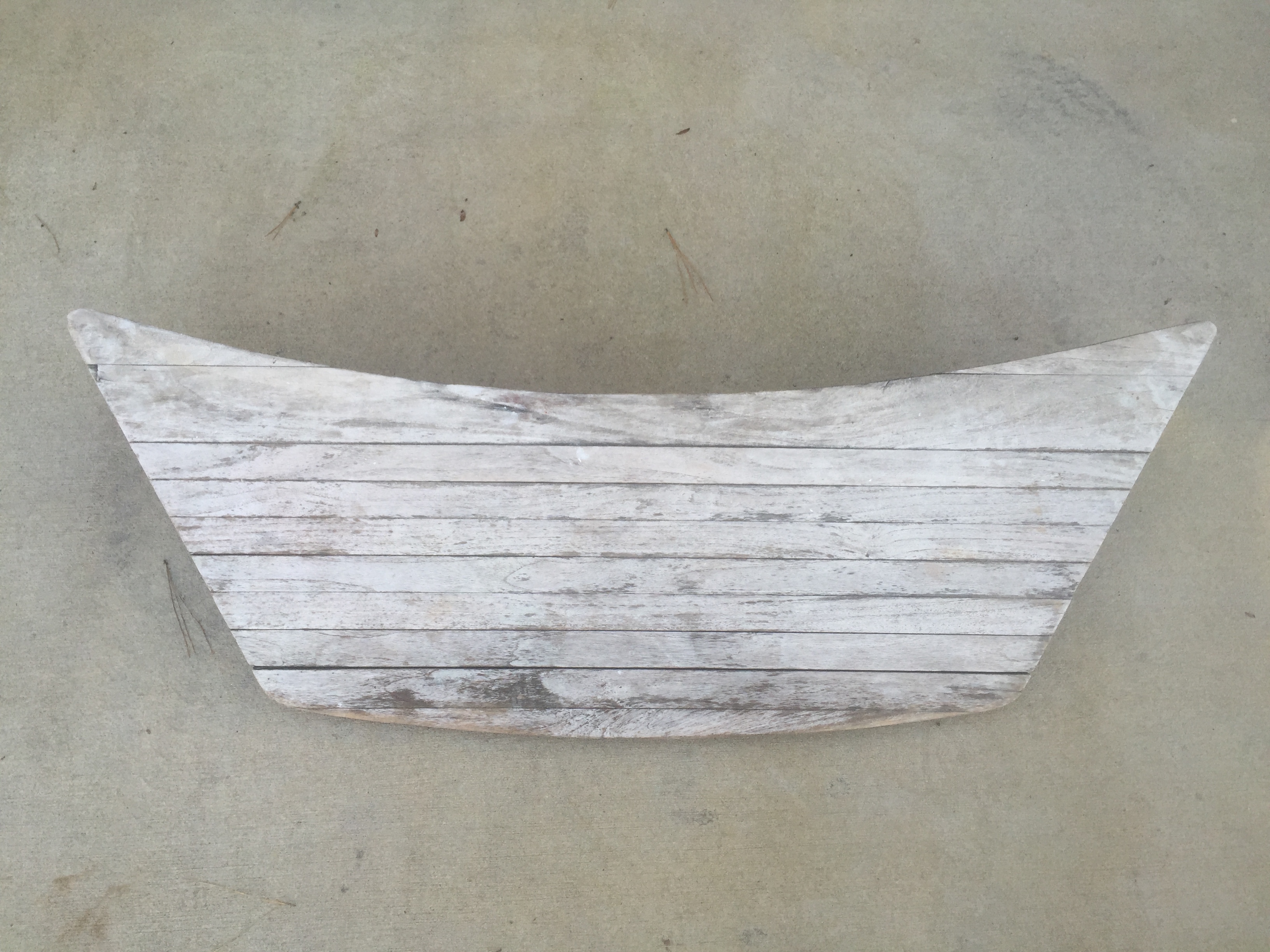

Here's a shot of it before restoration. I don't think the previous owner ever even oiled it!

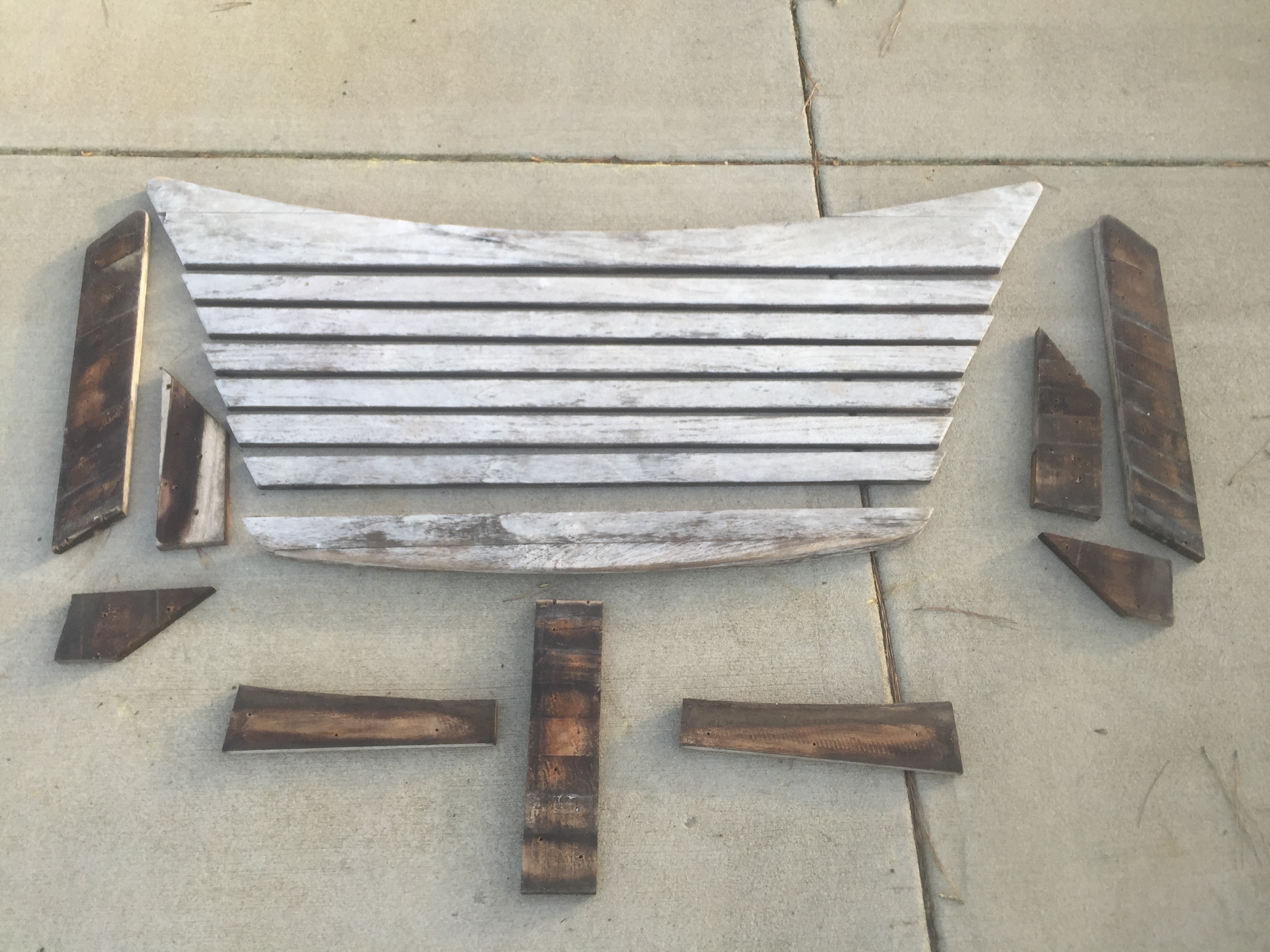

I took the whole thing apart, since there were several chunks of wood missing that required major sanding. There were also several screws protruding through the wood. Not something I would want to step on! Here's the disassembled platform.

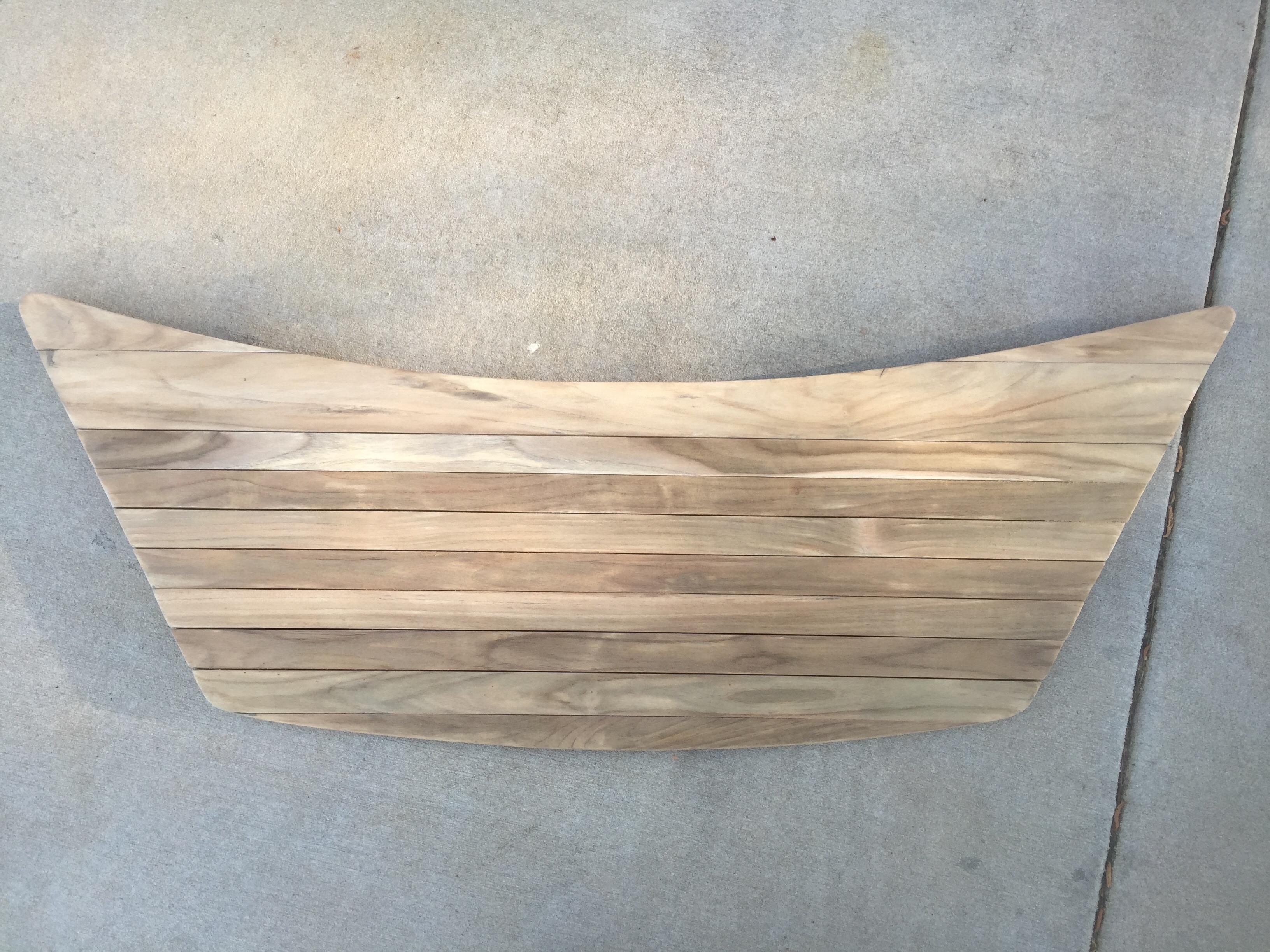

I sanded each piece with a belt sander, and then finish sanded them all by hand. I then reassembled everything. Here's how it looked after that.

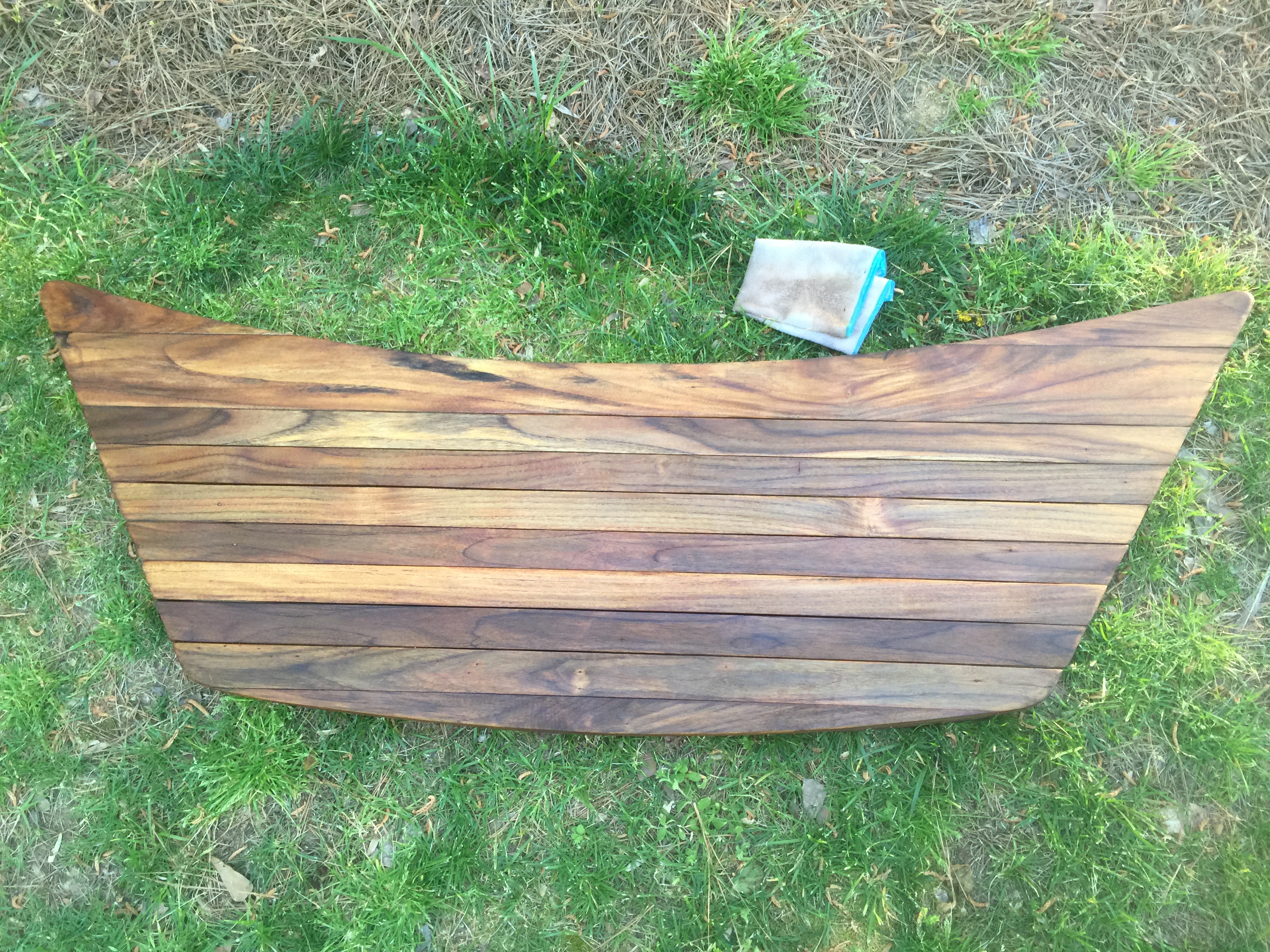

Here's the finished product, all oiled up and ready for installation. No more rough chunks of wood or protruding screws!
The underside looks as good as the top, although I didn't take any pictures of that. Maybe I'll take some tomorrow. It also got new platform brackets since the originals were broken and discolored.I own and operate Silver Cove Marine, which is an inboard boat restoration, service, and sales facility located in Mooresville, North Carolina. We specializes in Nautiques and Correct Crafts, and also provide general service for Nautiques fifteen years old and older.
