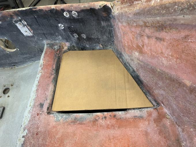

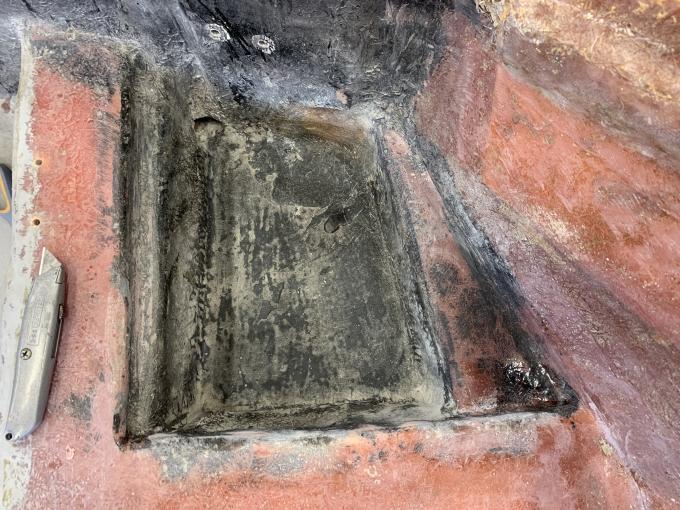

    Gunna make a couple more coosa board panels. These will be removable covers for the rear locker area. The rear lockers had these pockets cut out of the floor to allow for the hard tank ballast empty pump to sit. I’m going bagged ballast so these aren’t really necessary and so want to build a removable cover panel for them. The glass work in these pockets is really sloppy so some grinding and patch work is needed to straighten up edges and corners.

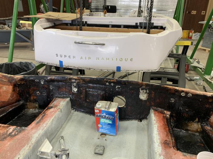

      Thought the black finish was gel coat but went to wipe down the areas with acetone for glassing and noticed the rag turned black... must be spray paint or something so it will need to be removed. Might as well do the entire area and then can pressure wash it all off after the paint stripper has worked its magic.

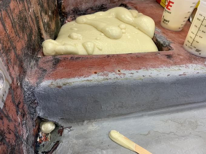

          This black stuff is a pain. It might be some kind of bilge coat or something. The paint stripper didn’t work too well it helped soften it and a wire wheel on my grinder is doing the rest. I think rather than build a panel for these pockets I’m just going to foam them in and glass them into the rest of the floor. They each have drains into the bilge and just trap dirty bilge water and crud so by glassing them in I can also close up the drains that run through the stringers and that way I won’t have dirty bilge water getting trapped in these pockets and having to clean them out all the time.

            This stuff is surprisingly fun to use....

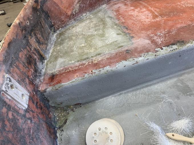

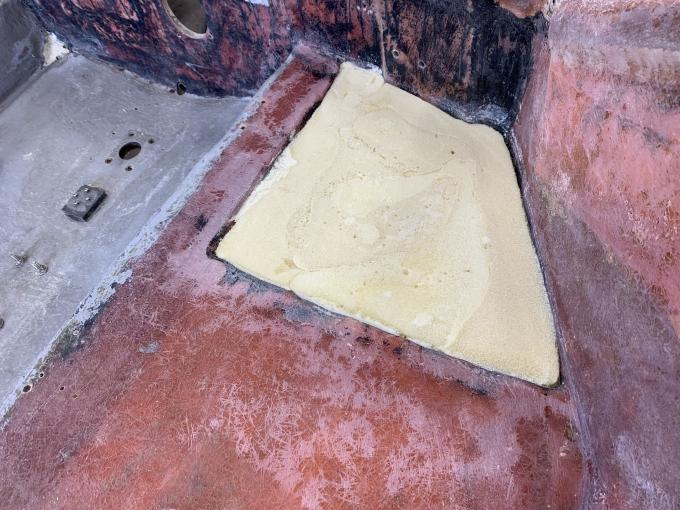

                Got the hard tank ballast pockets glasses over. This makes the locker storage more useful I think by having a flat floor all the way back.

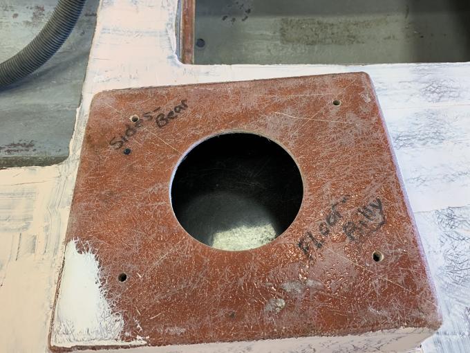

                  Filling in all the remaining fiberglass weave and low spots with some Adtech P14. It’s a rigid machinable polyester filler that is safe for below the water line so moisture isn’t an issue and it sands fairly easy. Before I cover it up for good....thought I’d give a shout out to Billy and Bear who installed the carpet at the factory and put there names on the drivers seat mount. I wonder if they still work at nautique????

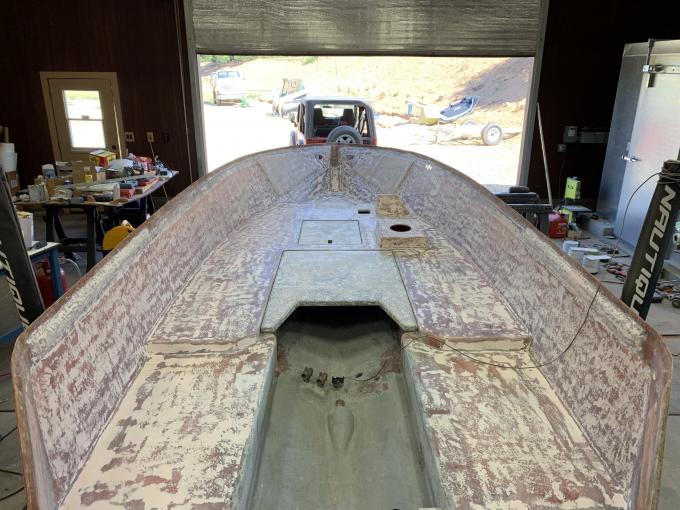

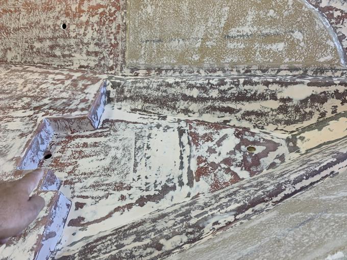

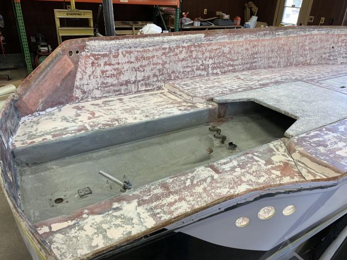

                        Lots and lots and lots of sanding..... this project is giving me grey hairs. Ready for gel coat FINALLY!!! Floor is still wavy and not perfectly flat but it is very smooth now so that should help the gel coat application.

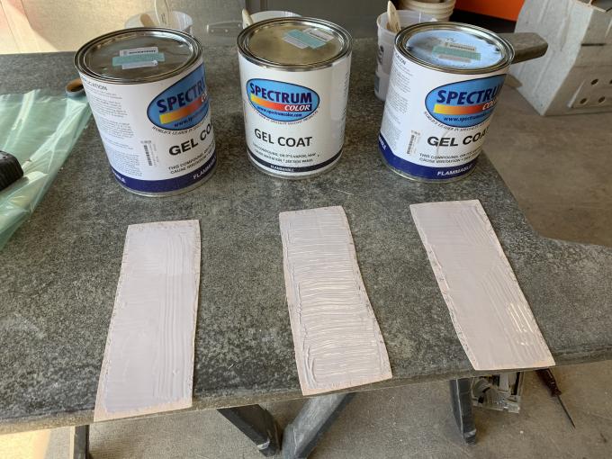

                          I have 3 gallons of color matched gel coat from spectrum.... since this is my first time working with gel coat I made up some samples cards from the Fiberglass products I used in the hull to ensure compatibility with this gel coat I’m using. Applied with a brush even though I’ll be spraying it in the hull. Wasn’t expecting any problems and it look like it’s curing and bonding nicely and the color is spot on between all three batches and the exterior of the hull.

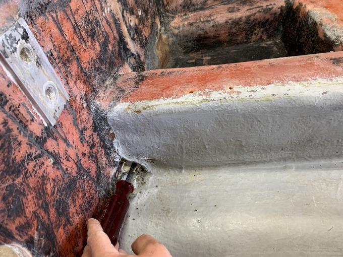

                            And one more simple but important modification. So everyone complains about the bow of these boats always being damp and smelling of mildew. I added a drain hole at the back end of the bow area. There is already one at the front but the front is usually the highest point so for all the complaints about bow carpet mildew in these older boats, this is why..... add a drain hole.
