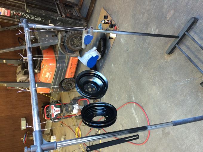

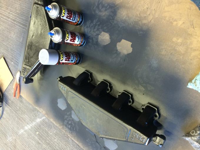

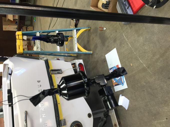

      Some of the engine components getting painted. I used all VHT high heat rattle can products for the engine and all the components. Depending on what it was I used different heat range paints. Like the exhaust manifolds got the VHT flame proof products which require primer paint and clear coat if you want a gloss look which I did so it would match the rest of the engine. The block and heads got VHT engine enamel which is also a primer and color coat process. The rest of the external components got VHT roll bar and chassis paint because it's an epoxy paint and applies much easier without running and requires no primer so long as the parts are clean. The only reason I didn't use the epoxy VHT everywhere was it only has a 250 degree rating where as the engine enamel was 500 degrees and the flame proof product for the exhaust manifold was 1300 degrees.

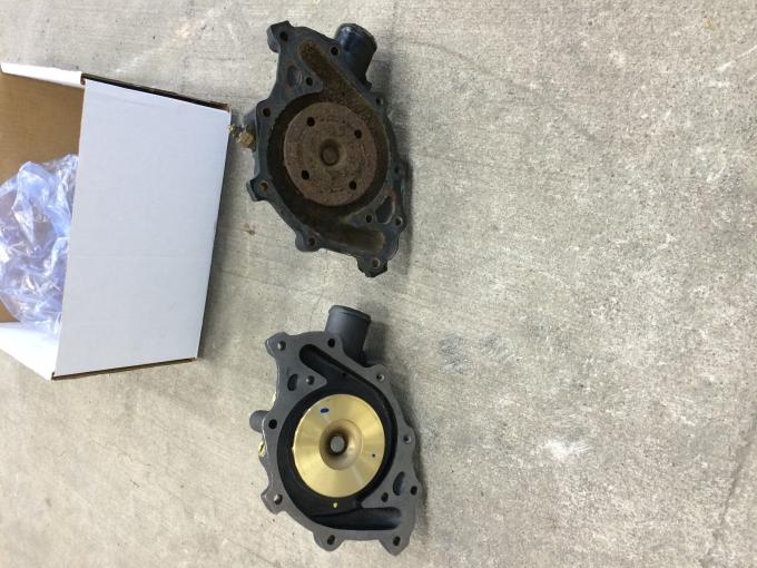

        Replaced the engine water pump while I was at it. The old one ran smooth and didn't leak but pump was just really corroded from age and probably never had the block drained after each use so it sat in a block full of water year round I imagine. Also purchased a rebuild kit for the raw water pump as well which was needed. Currently stripping and repainting the raw water pump but don't any pics of it yet.

          Originally posted by vvfdfirefighter View Post
          For those exhaust parts I would definitely look into HI-TEMP Ceramic Paint. I do a lot of Exhausts with that stuff. Its amazing. Glossy Finish and hard as a rock and won't rust. just make sure you bake it onto the metal.
          Yes that's what I tried to do with the VHT products. The can said I can cure everything on the engine by just running it several times at different time intervals. Kind of wish I at least cured the exhaust manifolds in my oven because those would have fit in there and I would have had better control of the curing process. Alas they are already bolted up to the engine and torqued down with the new manifold gaskets... I can tell the curing is very important though especially with the engine enamel. It's still soft and nicks easily.

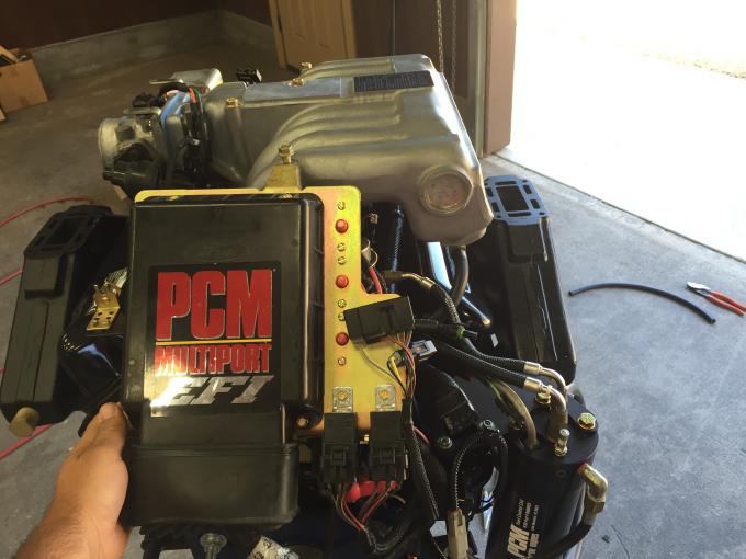

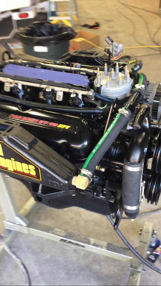

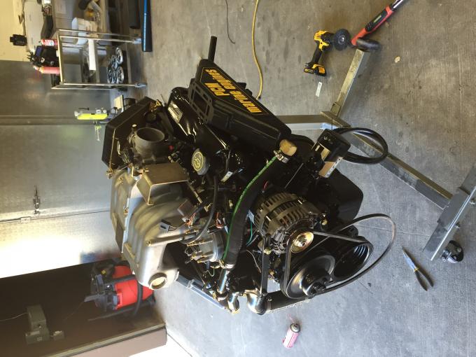

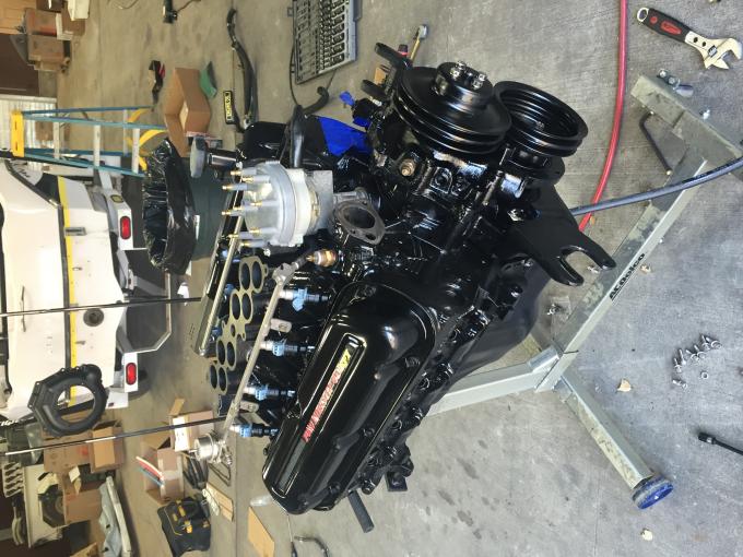

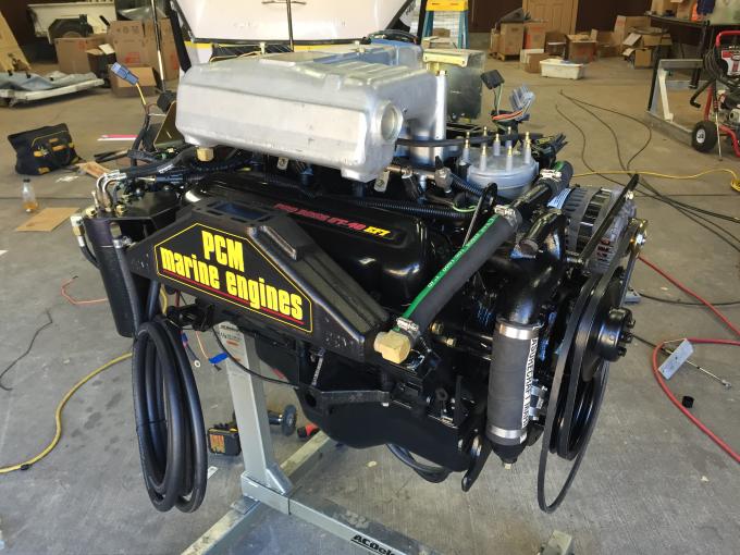

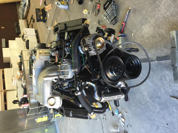

            Engine starting to go back together after the rebuild and painting of the components. Installed all new water hoses, gas lines and oil drain hose. I don't have the means to make the braided gas lines to the fuel rails or the transmission oil lines to the transmission oil cooler so those I'm just cleaning up best I can and reusing. Replacing any component that has a limited life span. Things like the fuel pressure regulator and thermostat, new distributor rotor and cap and will have new spark plug and wires, FCC fuel filter. The throttle body and Idle air control valve were really gunked up so had to give those a good cleaning and new gaskets also. New relays too just because I've read some posts here about fuel delivery problems due to a simple relay going bad. In anticipation of the new stereo system I installed a new 100 amp alternator kit to replace the stock 50 amp unit.

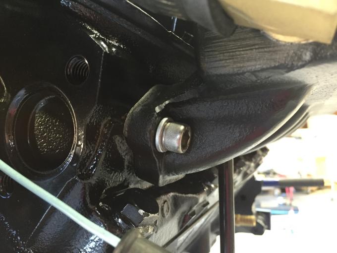

              #21

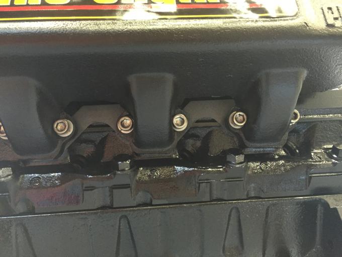

              Not sure if it was just my exhaust manifolds or if this is just how they are cast and machined but I had ordered an exhaust manifold bolt kit from nautique parts I think it was and they came with lock washers. When I took the manifolds off the bolts did not have washers of anykind which I though was strange. I couldn't get the lock washers to fit and realized that was why there was no washers on the exhaust manifold bolts. It made sense to have lock washers though so I used a dremel tool and opened up the flange area on the exhaust manifolds before I painted them so that I could get lock washers on all the new manifold bolts.

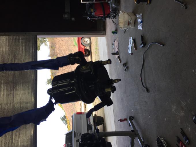

                              On another note, was Walter easy to deal with? The cover on the top of my v drive is cracked, likely from poor winterization from the previous owner. I think that the cover is where the cooler is that circulates water. I was going to see if maybe Walter could just sell me a new cover. It just barely seeps a drop of water every 5 minutes or so while in use. I'll post of a pic, maybe you can give me some insight since you've taken one apart now ðŸ˜
