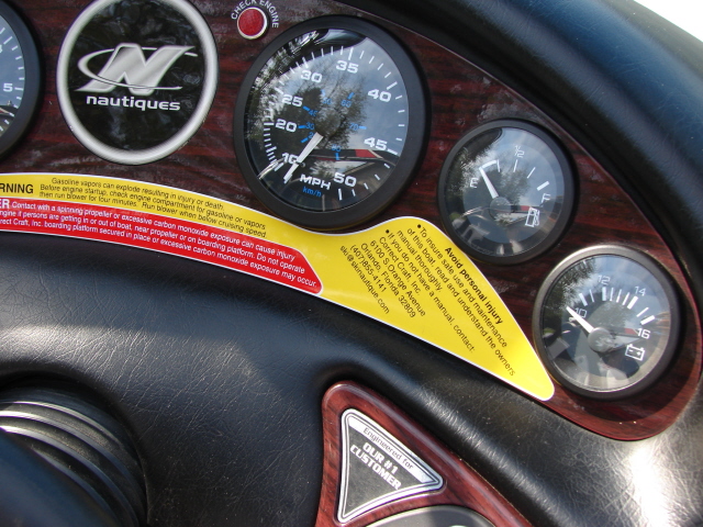

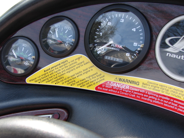

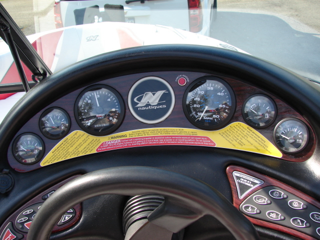

        here's the pics with the teleflex tach and speedo

          Python,
          What part # are those. Thats the first teleflex tach I've seen with an hourmeter. Did you have to install a paddle wheel?
          • pythonsupersport
            • Mar 2008
            • 33
            • Western PA
            the part numbers were 84310F, and 84510F. You'll need your economic stimulus check to cover them. But NO PADDLE WHEEL REQ'D. The only thing I had to do was run a new speedometer tube from the dash to the rear pitot.
