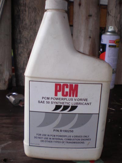

    PCM transmission requires Dexron III, and is a separate unit from their V-drive. V-drive requires 50wt. synthetic, Mobiltrans is difficult to get. An exact replacement is the Amsoil 50wt synthetic gear oil.

          SAE 50
          I have the answer to my question posted earlier.
          Mobiltrans SHC 50 Synthetic Transmission Lubricant (R190250)
          equals
          SAE 50 Synthetic Transmission Lubricant.
          Hard to beleive we couldn't get that answer from CC when we asked, many times......
          The manual confused me, I thought the V-drive and the transmition were a single unit, WRONG.
          Transmition Dexron III
          V-Drive = Mobiltrans SHC 50 Synthetic Transmission Lubricant (R190250) or SAE 50 Synthetic Lubricant
