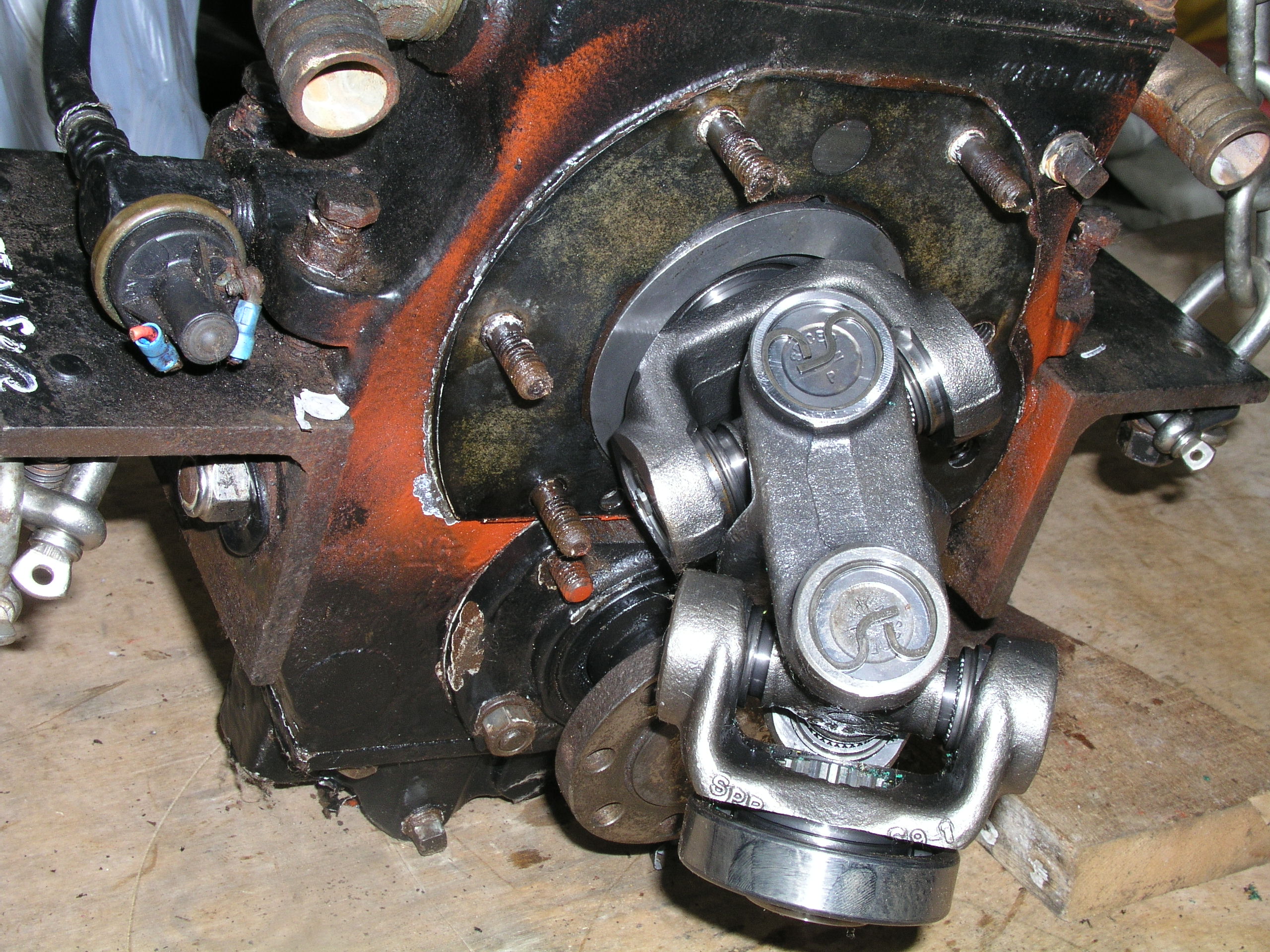

                  Can contact Mr.Don (staff of Walter Vdrive company,nice man)at : waltermach@aol.com ,they supply service kit for the Vdrive,a suspect is the wore universal joint,except this,other parts are much comparative strong.

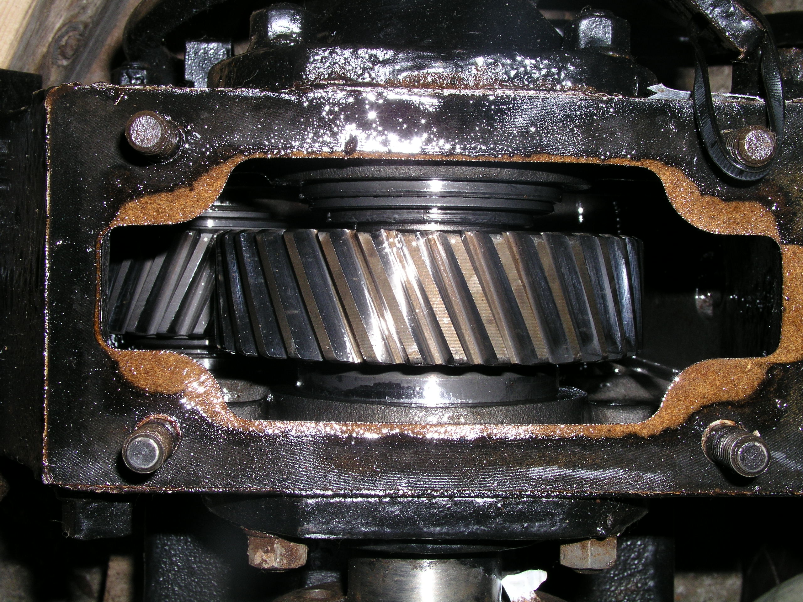

                      My buddy finally went a picked up the boat from the marina and is going to rebuild it himself --- he tore it apart this evening and all but one of the gears looked great - very little wear patterns, but one of the gears appeared to be soft (i.e. not hardened well).. all of the teeth on this one gear were worn completely down. He is supposed to be sending me some pics of it so I can post it here. Like I said, he's a very good auto mechanic. He's hoping that Walter will get him some parts Overnight so he can get it rebuilt and back on the water this weekend!

                        All tooth wore out? how many hour the boat ran? fortunatly, you have a able man to help this,I have unforgetable memory to take out the tooth and bearings and reput it.

                              It's funny how CC has stopped using the Walters in all except one of their boats. That one needs modifications to handle the replacement that will come next year. Too many problems over the years with the Walters that couldn't be solved. My understanding is this new drive uses bevel gearing instead of the "U" joint design. The way a V drive should be made! The only refference to "bullets" now, should be the ones Walters is sweating due to all that lost business but it is their own making.
