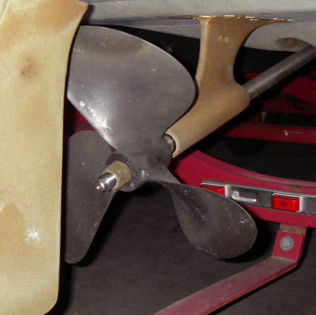

yeah I can't see any bushing...and I'm getting a little vibration from 640 to around 1000 rpm... the shaft/prop is 1month old and they're mint. my gf ate my rope..maybe it chewed up the bushing?
if the boat is smooth above 1000 I highly doubt you have a problem with the bushing... how bad is this vibration (which sounds like it's basically at idle to high idle)?
may be a minor engine misaligment occur if you feel vibration after new prop and shaft are changed, for confirm this,loose all the shaft coupler screws 3/4- 1 turn, this symtom will disapear.
