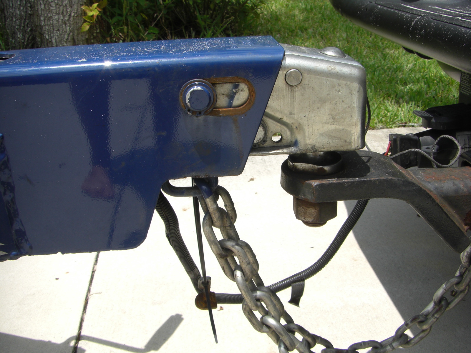

Hi, two thoughts for you:
1
Some hydraulic brake actuators intentionally generate pulsation or knocking when the brake fluid level is getting low to tell the driver to top it off, so might want to double check and make sure its full.
2
Looking at the picture you included on how your actuator attaches to the ball, it appears that the actuator is coming in on an upward angle (maybe its not in reality) and if that is the case this will exaggerate the knocking you feel as its pushing the ball and hence your rear end up. This can also compromise the handling/safety of your rig under hard braking conditions.
