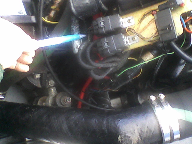

                Daniel,
                If you have time can you take pictures of the different relays saying which one is which and a decent view of the ngine so I know where they exactly are? Thanks

                  Here is a picture of the relay location. Ignore the pen pointing to the underside of the plate the two relays are mounted on.
                  One of the two relays controls power to the computer, the ignition, and power to the fuel pump relay coil.
                  The other relay is the fuel pump relay. Both relays are identical. The electrical harness will reach either relay, so I cannot tell you the one on the right (or left) is the fuel pump relay.

                    The fuel pump relay will have wires with the following colors:
                    Blue/Orange
                    Red/Purple
                    Green/Yellow
                    Purple/Black
                    The computer relay will have wires with the following colors:
                    Purple
                    Black
                    Red/Purple
                    Purple/Black
                    Look for the Green/Yellow wire. This is positive to the fuel pumps.
