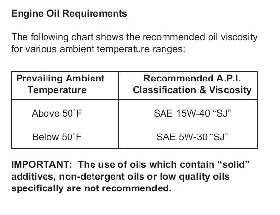

    I'm a new owner of an '04 SANTE and this is my first boat. I want to change the oil in it but I can't find anywhere what weight oil is recommended. I would appreciate any advice anyone has.

    Should say on the oil fill cap on the engine. It should be 15W 40, that what I use

        I just checked my filler cap.......nothing.

          See clip from 2004 manual.
          I use Mobil Delvac dinosaur oil. Label says for diesel as most 15w40 oils do but have the appropriate or better API S"x" rating. The others are good too: Chevron Delo, Shell Rotella, Ford (not synthetic), yadda yadda. Do not use Mobil 1 or other synthetic oils.
          Based on your Pennzoil number, you must have a remote filter.... and it is the "legacy" Ford filter...meaning the filter that fit almost every ford ever made prior to the modern engines that now get a special/unique filter. Here is a list by mfg for remote mount filter:
          FRAM Part # PH8A
          ACDELCO Part # PF2
          WIX Part # 51515
          Motorcraft Part # FL1A
          If your brand is not there, look up a filter for a 1990 Ford F-150 with a 302 V8.
