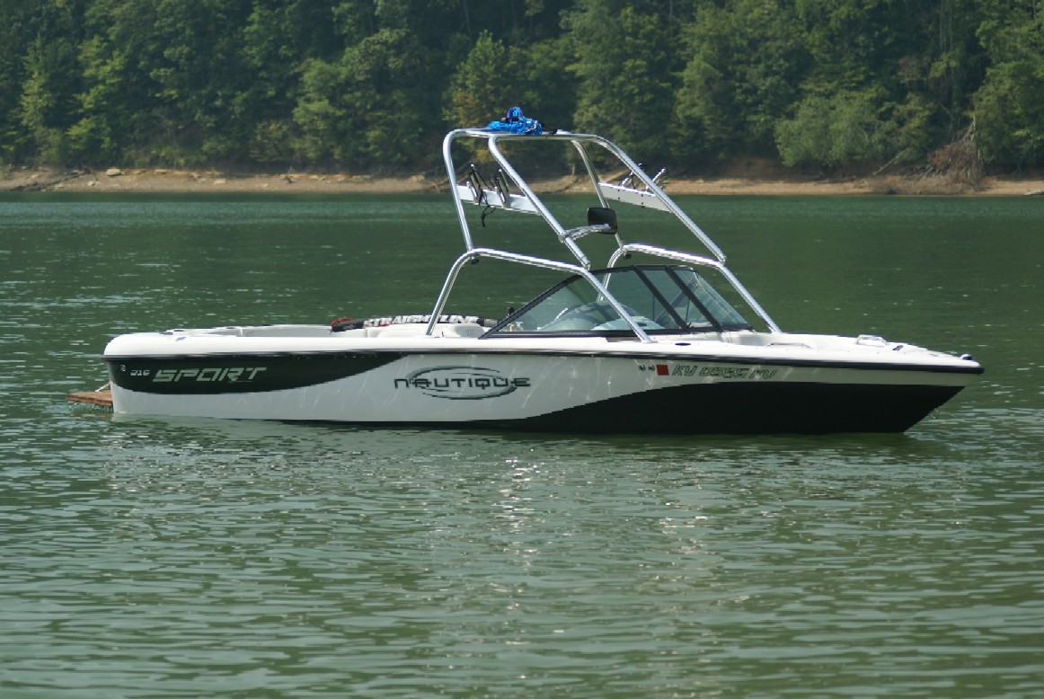

                    Here is a picture of my boat (now with tower) just around the corner from Wisdom Dock.
                    Proud2BeCC
