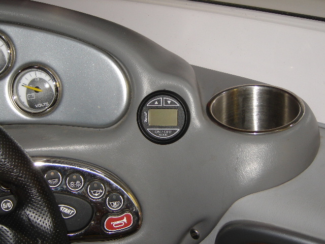

          RE: Re: RE: Depth finder ?
          Its a regular 2" faria depth gauge....I removed the dash 12volt cig plug, and just cut the hole a bit bigger and popped it in there....I'll take a pic the next time I'm at the lake....

            faria depth fnder
            • ksarbau
              • Mar 2008
              • 52
              • Indianapolis, IN
              • 2016 G23
              Thanks for posting the picture. It looks nice - I think I'm going to do the same.
