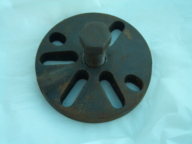

        my tool
        This is the tool I always use for seperate the couple and shaft,I borrow it from my friend,but this can find in hard ware tool shop.
