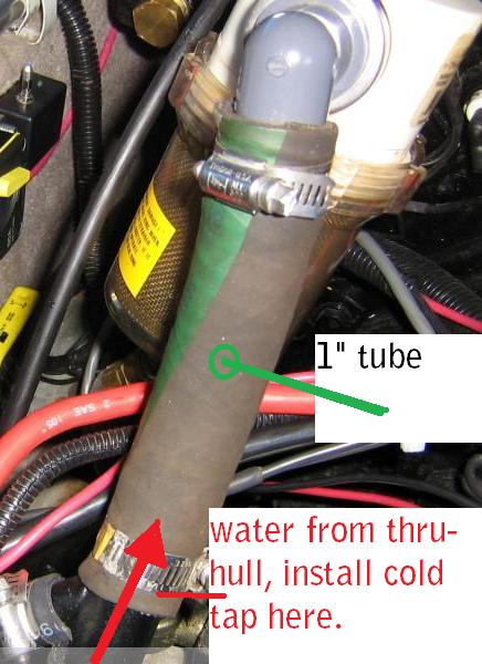

        The 1" tube is the line that runs from the thru-hull scoop, through the strainer, and into the Raw water pump.
        So you cut that line for your cold water source (usually it is the black/green-striped hose) coming up from the thru-hull and running into the strainer. Install the t-adaptor that came with the shower kit, and basically the cold water is whatever the lake temp happens to be that day.
