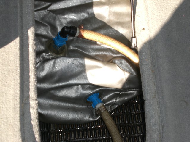

                Here is how it is set up now. This fat sac is only 375. The top drain sometimes pops my locker open when full. I just tied this on to the factory pumps. That year its just one switch, fill and empty. It has two pumps that fill and one that emptys. I have a hard time draining the locker sac. It has no problems filling though.
