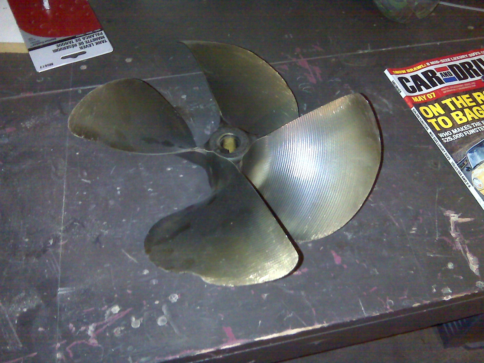

    2 questions:
    I have an ACME 422 prop that I mangled. where is the best exchange a prop? i am in Canada so will be shipping

    send the prop direct to ACME...not sure about the steering box.

      I'm not aware of any "exchange a prop" services. Have it rebuilt (if rebuildable!) or, as mentioned the best option would be to send it directly to Acme.

        If you need it repaired, email Bill Weeks at Acme. His email address is bweeks@acmemarine . Repair cost is $120 + shipping unless it needs some welding.

          I dont believe Acme does all their own repairs- at least that used to be the case. Either way, Acme wont repair the prop any differently that any other qualified shop. Ive heard good things about repairs handled by Delta- and you should save some $$ to boot.
              Actually, they do their own repairs as a lot of places do not have the proper prop blocks for Acme props. I found that going to Acme direct was cheaper than any of the local shops.

                I know they do some, but do they do all of their own repairs? I dont believe so- I know they subbed out a certain percentage of the work in the past. Youre correct about the blocks, but many many shops do have them. Besides needing the correct blocks, theres nothing special about repairing a CNC prop. I had a local shop do one of mine. Many here have had great experiences with Delta. Acme's repair service is one of the more expensive options, and some people have had problems with their work in the past. Do a search.

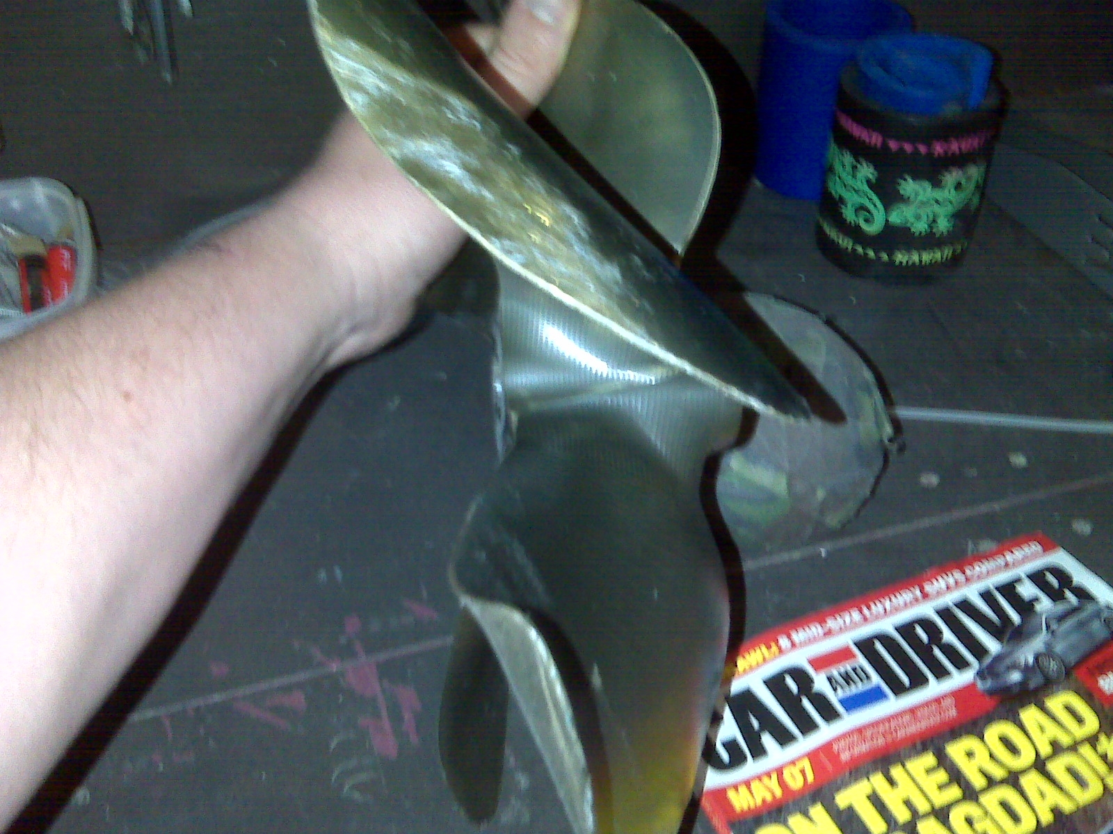

                  Good info! thanks everyone.
                  i took pictures of the prop, and sent them to two places in Canada. 1 quote was for $150 - $200 plus shipping, the other was for $160 max, shipping 1 way included.
