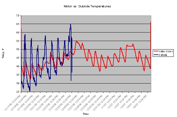

                          • Mikeski
                            • 2908
                            • San Francisco, CA
                            I wouldn't winterize and wouldn't worry as long as the AVERAGE 24 hour temperature did not drop below 30 degrees.
                            • GoBig
                              • Apr 2008
                              • 551
                              • Santa Cruz, CA
                              Mikeski, how did you pull that data? That is good info. Where do you store your boat?
