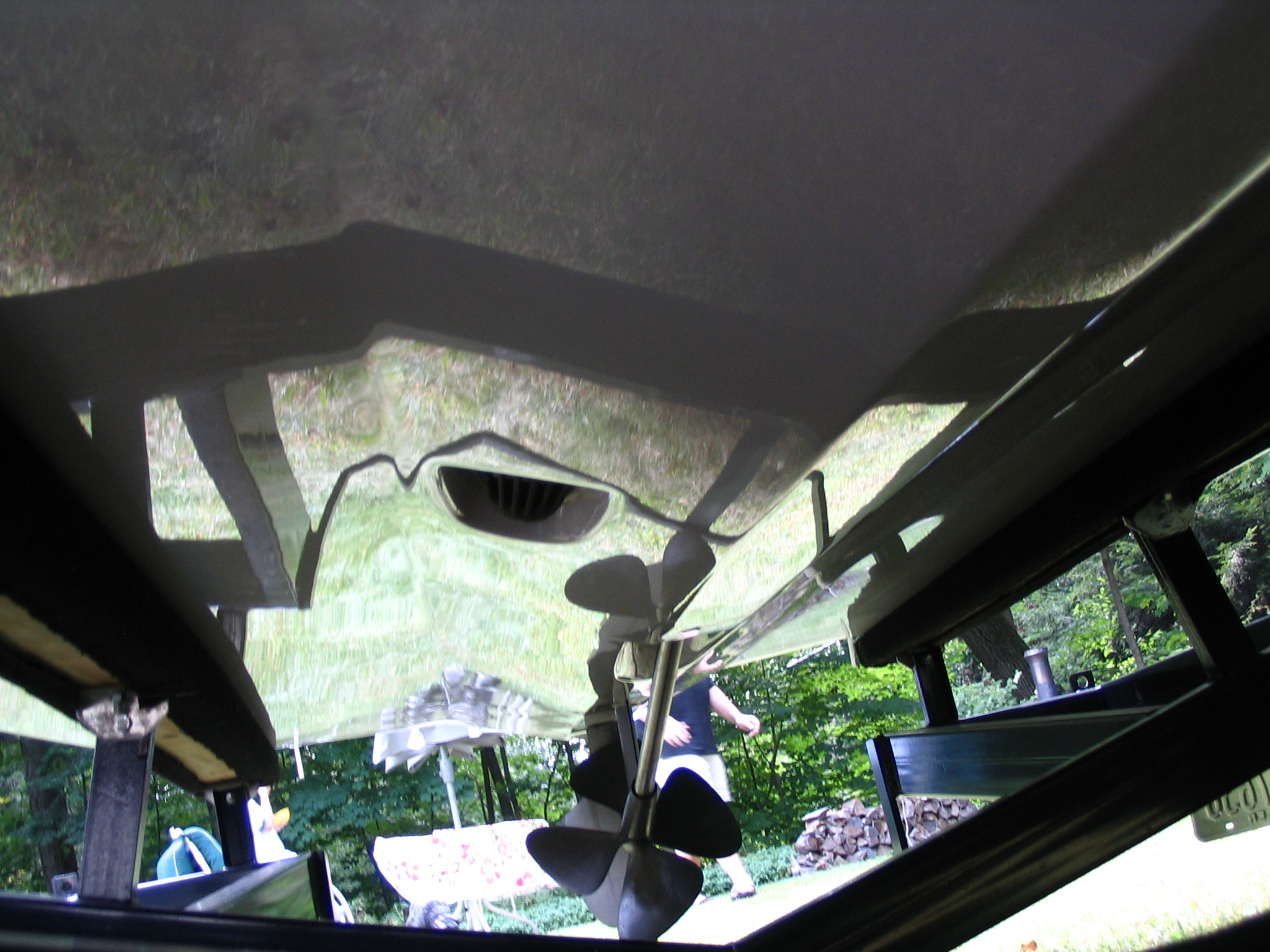

    Does anyone have experience using a Fake-A-Lake with the TSC hull on a model year 2001 SN 196? I"m interested in knowing if the hull shape around the water intake is compatible with the rubber end of the fake-a-lake.

    My tsc 1 intake would not work with the fake a lake shape. The water intake grate was to long for my fake a lake.
    I usually pull the intake hose off of the intake fitting, and then I have a piece of clear tubing (1" I think) that is about 6' long that I put into a 5 gallon bucket.

          The one I had was an older model, maybe they have changed the design since? Mine was round aprox 5" -6" across and looked much like a toilet plunger. It worked for my MC, but not my Ski or Sport. Is your water intake round or elongated?

            I've read about the flushpro and that looks like a good solution also. I was trying to not introduce more parts into the water intake system where air leaks could form someday.
            Here is a picture of the bottom of the hull showing the intake. The boat is 300 miles from me so I can't take a better picture at the moment.

                  JEClarke: Is your screen missing?

                              we used a piece of rubber matt, 1" thick
                              cut it square like 12 x 12
                              then cut a hole in it for the fake-a-lake
                              works good
