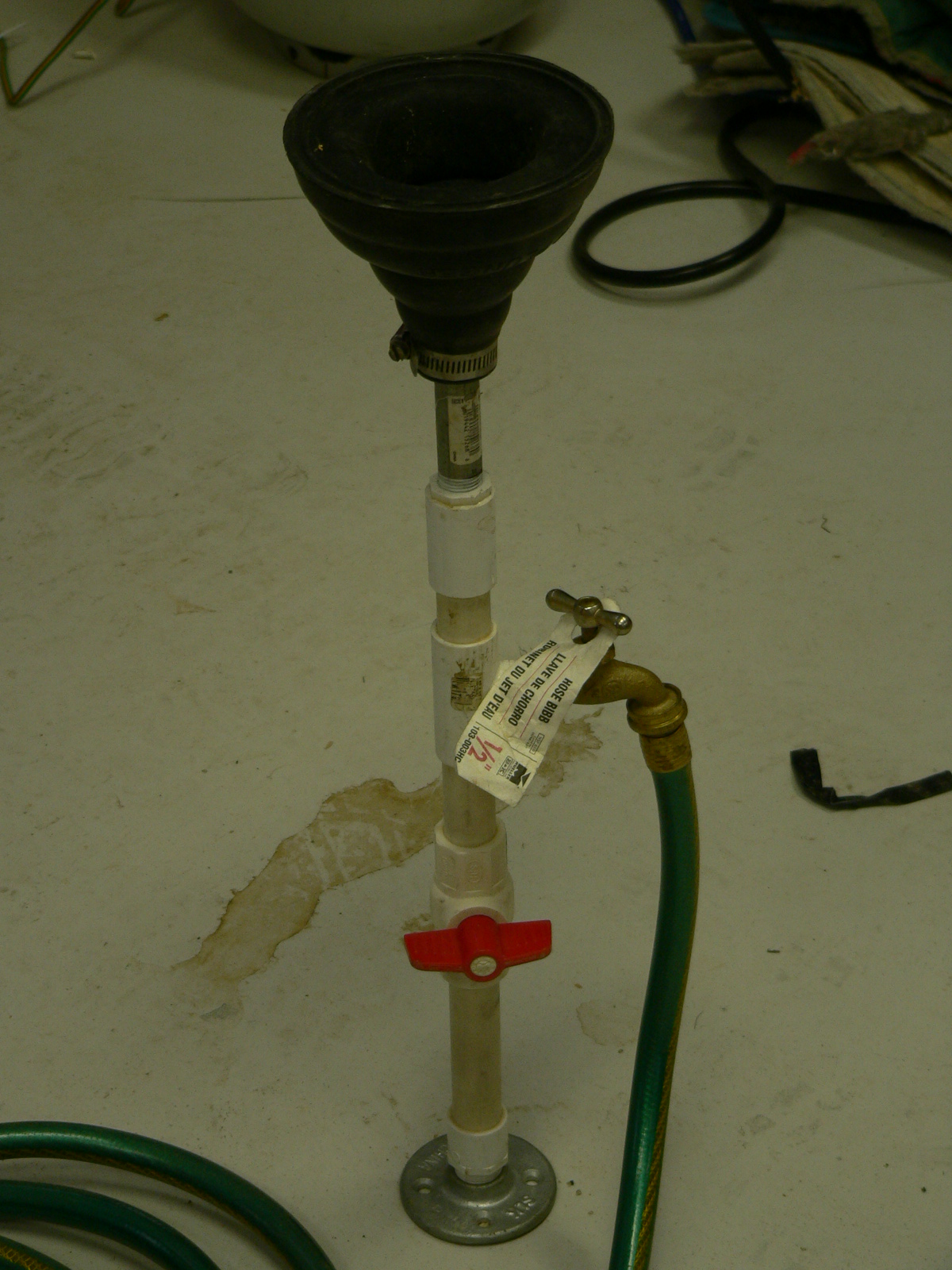

          I made one with PVC pipe and a toilet plunger. Will tr to post pictures later

            Yes, just a cheap plunger from the hardware store, I always run it on the trailer, parked in the grass so the right length isnt a problem, as i just wedge it up underneath the boat, with the wooden handle sticking tight into the ground.
            The rubber cup is just fine, i sliced an "x" in it and just jam the hose through that.

              Attached is wyat I use on my "96 Sport [/img][img]
