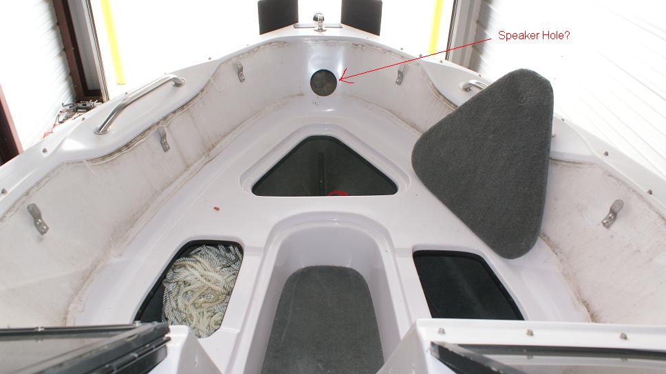

      Anyone know what this hole is for? Is this a speaker hole? My interior just had vinyl over that hole with "Correct Craft" embroidered there. I was thinking about adding 1 or 2 speakers to the front area. Were there other 99 nautiques that came with a single speaker in the nose?

        I don,t know but my 226 has the same hole. If I had to guess I would say a wrench access to the lifting eye bolt/nut.

          That's what I'd say also.
