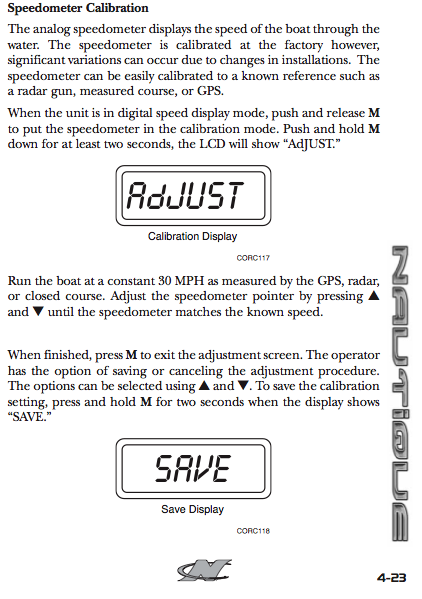

Anyone know how to adjust the analog speedo on a 08' 230. It runs about 5 to 6 mph slower than the Zero Off. Manual shows there should be a knob below dash just above rt. knee but no such knob exists.
The manual should have a procedure for adjusting it via the arrow keys on the front of the gauge, unless it is a Signature Edition boat. SE boats will have the knob under the dash for speedometer adjustment.I own and operate Silver Cove Marine, which is an inboard boat restoration, service, and sales facility located in Mooresville, North Carolina. We specializes in Nautiques and Correct Crafts, and also provide general service for Nautiques fifteen years old and older.
Yeah, here you go.
Thanks for the info. I checked manual again online. Here it is

That is only for the Signature Edition boats (not Limited Edition or Team Edition boats). The Signature Edition boats do not use the digital gauges, and have their own adjustment method.I own and operate Silver Cove Marine, which is an inboard boat restoration, service, and sales facility located in Mooresville, North Carolina. We specializes in Nautiques and Correct Crafts, and also provide general service for Nautiques fifteen years old and older.
