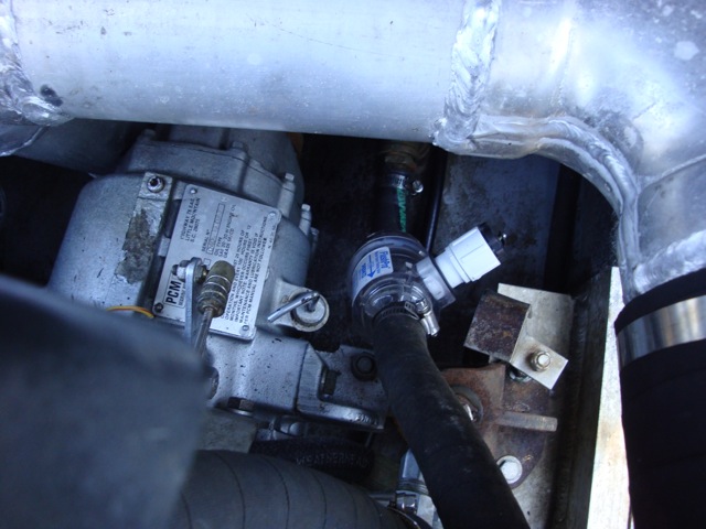

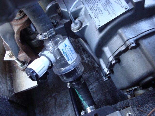

Can anyone post a pic of the Flush Pro installed on a GT40? I was looking over my system yesterday and couldn't really find a good spot to put it. I might have a spot right before the water filter, but it will be tight.Now

Originally posted by ChexiCan anyone post a pic of the Flush Pro installed on a GT40? I was looking over my system yesterday and couldn't really find a good spot to put it. I might have a spot right before the water filter, but it will be tight.
I'll snap some pictures tonight and post them up for you for reference.2001 SAN
This is currently how the hose attachment is installed. I would like install a hose adapter on the transom to make it more convenient. currently you have to drag a hose up in the boat. I still have a raw water strainer to install in line with this, i just haven't had a chance to get to it yet.
Should be 1"I own and operate Silver Cove Marine, which is an inboard boat restoration, service, and sales facility located in Mooresville, North Carolina. We specializes in Nautiques and Correct Crafts, and also provide general service for Nautiques fifteen years old and older.
I had a flush pro shear...it's just plastic. To upgrade my install, I replaced my thru hull intake shutoff with a 3 way ball valve. Unlike the flush pro, I need to manually switch the inlet to flush but there is no question it is a much more robust setup and I have eliminated a potential failure point.
